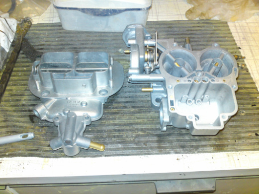

I do carb rebuilds, so I had all the gaskets to establish the hard dimensions, but a screen dump into "Paint" does the rest.
