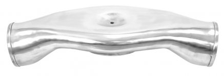

So when you look at this picture, the hood has a dimple in the support to clear the factory aircleaner. That dimple land right ath the radius of the top of the carb. I had to bend the filer support down on that edge and cut the mesh to clear the hood. I saw the dual out carb hat from spectre that I could put a dent in on the shock tower side to help clear the hood. And I could just put the filters on each end and maybe fab a shroud for each so the header heat isnt completely killing the air.
What do you guys think?

Do U have 2 1/2 inches clearence?
Have U tried the "modeling clay squish"?
That would be the 'true test' of conditions…
I like the spectre idea as it may wrk
/AND/
get more air in there. Just can't tell if U have the room
(I got a 2nd & 3rd hood, 1 has a hole cut right where I need to guage it).
Good Luck, keep talkin.
