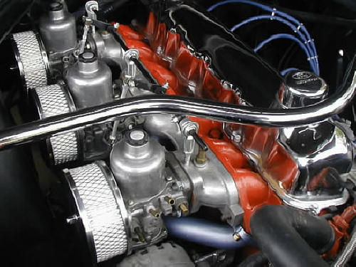

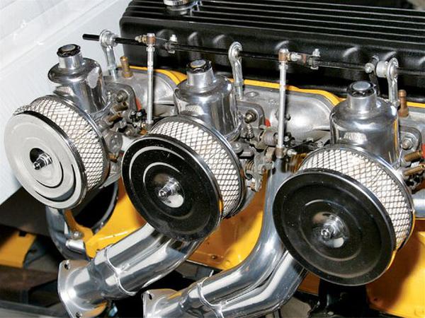

There used to be a common 3 SU 2V intake that could fit the Classic Inlines head. Aussie Speed is making them again.
The US had the Rambler semi log headed six cylinder engine with a plate adaptor.
The English re-invented log intake sixes in 1951 with the Ford Zephyr six and then the the US 144/170 Falcon engined copied the idea... but it was more common to do what the English used to do with its log head engines, and weld a BMC C series 2.9 liter type flange on the factory log head and put your two or three SU's on it that way. Blattman, Lynx made kits before the 2V head in 1971, and sold giziilions of them to the speedway guys to convert 1968-1970 221 and 1971-1975 250's over the better breathing SU's.

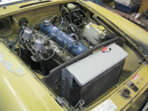

MGB. Engine fits w/ heater shelf removal, and looks like it will fit with the heater shelf in situ

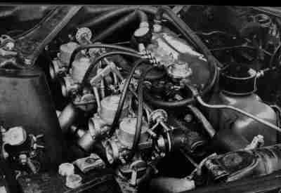

xctasy posted a pic of the engine in a car using the log and two SU's. This car has the heater shelf removed. As you can see, not really running into much like shock towers, and you can knock the inboard upper corner oft he RH footwell off for clearance. Or push the motor forward a couple inches
