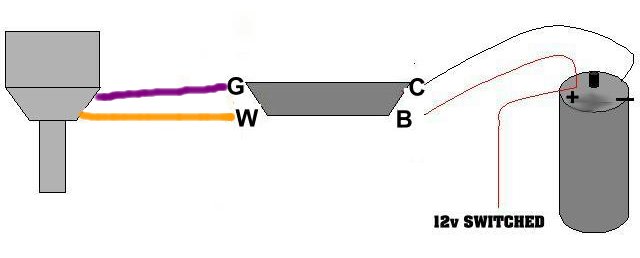

Keep the DSII, don't worry about the stock wiring if you don't want to. Personally I went with a Chevy ignition module to control the spark on mine.
If you need help wiring, head here (this was literally the first website that popped up when I searched for "GM wiring with Duraspark 2" but it looked fairly complete)
http://www.binderplanet.com/forums/inde ... ion.48435/
This picture itself is the same one that was on the article here that I originally read to do this. http://www.binderplanet.com/photopost/d ... module.jpg
Make dadgum sure you put a heatsink under the GM module, and make sure you ground the heatsink. I went complete overkill on mine and got a CPU heatsink from a computer repair shop.
