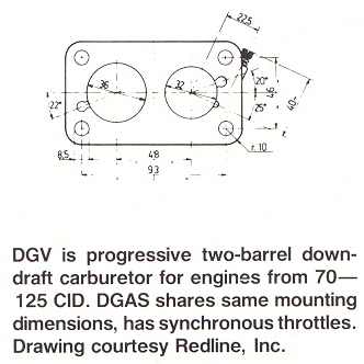

Since I've done Holley to Webers since I was a schoolboy,
Actual Weber adaptors are used on everything from Toyotas, to Nissan/Datsuns Slant Six Mopars, Chevy L6's etc
There is another which is handed
(Holley Weber 5200 is a handed version with the 32 mm primary and 36 mm secondary swapped around)
Each has bolt spacings 47 mm by 93 mm, but its easy to miss-read, and get them mixed up
Only warning is not to use the 50.8 by 95.25 (2 by 3-3/4") Rochester 2CG spacings, out a few mm
Nor the unsafe T-jet 50 by 90 Aisan/Nikki
