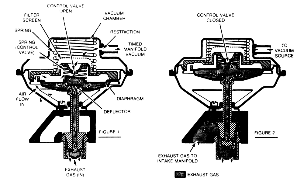

I understand that limiting the vacuum advance will cause the engine to run hotter and thus warm up faster. Anyhow after my test drive about 5 miles or so I shut it off and noticed a clicking noise almost like the sound of an aluminum engine cooling down. After further inspection and getting out my stethoscope I determined the sound is coming from the EGR valve. I'm not kidding it sounds like a clock ticking, lol. The EGR valve has been disconnected since I bought it.
I am curious if anyone else has any idea about the cause of this noise.
