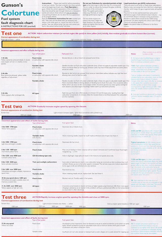

Color tune spark plug to set idle air fuel. How fat or thin you go is based on what you see
https://www.youtube.com/watch?v=Y9t8XhFlKbk
it will still give you a picture of what is happening inside the cylinder. But with modern fuels I find the color scale is off. when i tuned to what Gunson says is a good colored flame, all other tests indicated a too lean condition. So I still use it for tuning, but I don't shoot for an all blue color anymore.
colors from test 3 are what you are dialing for.

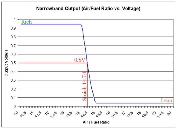

Then put in a Bosch 11027 Oxygen Sensor, Universal Type Fitment narrow band o2 sensor
with a Sunpro CP8200 StyleLine Air/Fuel Ratio White Dial reader.
https://www.youtube.com/watch?v=ocB-FyNRtgE
You don't need a wide band.
You need to trust the simple mechanics, and then you can richen or lean it as a warmed up vehicle test.
Under acceleration you'd expect it to drop out way rich, outside the range. When cruising, you'd expect way lean. 16.1:1, not measurable.
0.1 volt up to 0.9 volts ---->13.5 to 15.5:1 air fuel, then it drops out radically
no a/f gauge needed!

Yeah, but a used O2 narrow band sensor and 30 bux SP CP8200 will get you in ball park really well.
I'd use both.
Engine stumble could be a range of many other things, good igntion is first. Then just following the tune up rules. On a 1-bbl, the air fuel rading between cylinders varies so much, a Colortune picks it up, a single point wide band doesn't. A narrow band is so cheap, and it allows you to plug in a 1/8" adaptor and get back pressure.
Problem with a wide band is the air fuel ratio varies 2.5 points A/F between richest to leanest cylinder, so a wide band isn't going to actually give you an accurate number. Someone like wsa111 can use it, and get good info because he knows what lean missfire and igntion advance and retard does to the car.
For the rest of use, ball park is important.
Don't go overboard, but spending 250 on just a wide band system won't give as much value as the color tune will for cylinder to cylinder air fuel variance.
And that's a fact.
Color tune needs some simple calibration, and if the EPA is okay with 100 million narrow band equped cars triming air fuel ratio to 14.7 or 15.1 in our oxygenatied world, then its fine with me too.

...the color tune will for cylinder to cylinder air fuel variance…."
excellent advantage, no? ($40 - $70)
but not just what Asa needs?

I'd take the time out to get some cheap tell tale mixture detection. Serious about color tune and narrow band and backpressure. You can run a 1-bbl carb 200 six quite lean, right off the dial is about 15.5 or more, and the gauge is a good idea to know if its leaness or richness that causes the flat spot.
Everyone with a YFA'd 3.3 finds them finicity, but one jug feeding six pots creates some bad transitional lumps, and a poor idle.
Using an unlit hand propane torch or propane bottle with a petcock to turn on or of at the carb, do a leak test while the engine is running.
