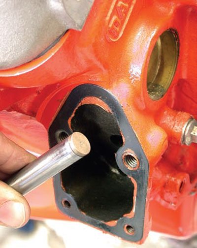

I don't, tt350 chevelle's system really works, For Fords, we don't have the Chevy pocketed fuel pump arrangment. You can use the same scheme if you use a shortened Chevy pushrod, and hold it to the cam with a honed intermediate plate.
Here's tt350 chevelle's decription of his SBC carb turbo with Carter Super Strip fuel pump. It allows the pump to be mounted with the diaphram downwards, although if you want to, you can run the pumps either way.
tt350 chevelle wrote:This mod closes off the the drain area and allows proper boost pressure to be seen at the diaphram, the "leaking" boost from the pump seal has no place to go.This worked as I expected but the fuel pressure would rise at a greater rate than 1:1, it was easy to get 20+ psi of fuel pressure (running about 8psi boost)
The solution to boosting well past the 12 psi level safely is to seal and pressurise the fuel pump with a SB Chevy method.
Run the pump off a shortened Chevy pushrod, and drive the Carter Super Strip pump via the Chev rocker arm.
They have a 1/2" rod 5.75 or 5.95" long, which operates off a 0.337" max lobe lift.
Fords I6 era pumps had Eccentric total lift of 0.290-0.310 inches. Basically, you add an additional steel plate with a 0.505" hole, and seal the fuel pump off, and use tt350 chevelle's presurised chamber method. Splash lubrication works for the times of lower speed, lower pressure.
https://www.theturboforums.com/attachme ... pg.459273/
https://www.theturboforums.com/attachme ... pg.459272/
The SBC pushrod operated pump has an intermediate plate covering a vented to the crankcase pocket.
Inside, the pushrod moves in the cast iron machined bore, with the drain hole below...
All the FE era onwards Ford V8 stuff traditionaly had 2.5" eccentrics, with strokes of 0.581 to 0.700 via a pushrod, so they don't work. Nor does the old 0.200" stroke Flathead Ford system.
I haven't worked with them yet, but the SBC Billet Piston fuel pump is pushrod operated, and it looks like the ideal solution

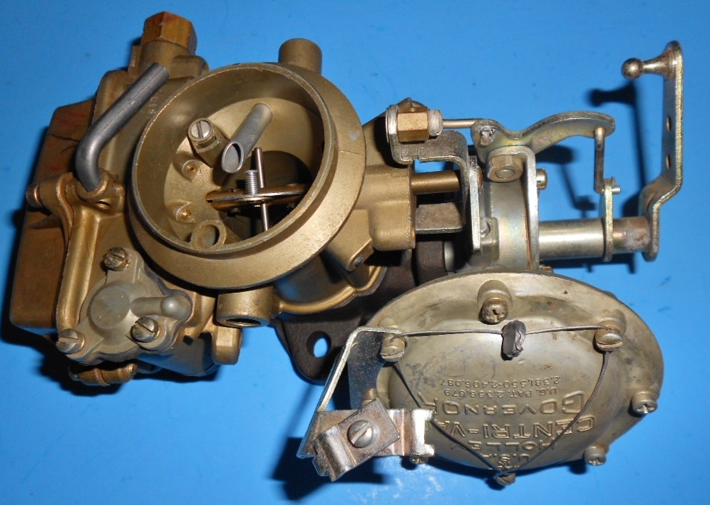

Do any of those industrial small sixes have working carbs?
The industrial carbs don't have accelerator pumps and the 1904 that I am using on my skidsteer isn't working properly and I'd like to get acquire a spare.

No, according to Michael Mayben, the Post Apocalyptic IHI Guru
https://vimeo.com/8149690

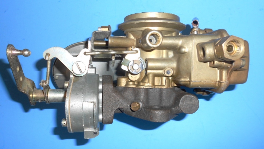

the vast majority of little snow blowers, offroad snow travel vehicles used the 1940 Holley supplied by Autolite, and there are just generic differences with that carb.
Holley 1940 ,Part Number R 6123 Autolite PN D0JJ-F Rekit 3071.Its a small bore, small throttle carb, not the big one.
Stationary engines, often 170, no pump. Often Holley 1904 or 1908 often with CENTRI-VAC Governor # List 2806 S, or the other G kind without the non plunger non rubber piston seal in the accelerator plunger.
http://forums.ihpartsamerica.com/showthread.php?t=6056
i have a similar carb, this one off a versatile 400 swather (ford inline 6 200cid). it also lacks an accel plunger and has a similar screw that bears against a small button in the accel valve diaphragm (as in your photo), and a spring that bears on the same side of the diaphragm. the parts look original. i assume that this is a vacuum activated accel pump. when vacuum below the throttle plate is high (at idle) the diaphragm is drawn toward the screw, against spring pressure. when the vacuum drops (throttle opens) the spring pressure overcomes the vacuum and the accel pump delivers additional fuel. the screw located in the bore where an accel pump shaft would be seems to control the volume of fuel that the accel pump can deliver. this is a governed engine so acceleration from idle is infrequent but loads may change frequently so an accel pump linkage with the throttle shaft may be undesirable.
i haven't been able to find a rebuild kit with a short shaft on the accel pump diaphragm so i'm considering a similar mod to the one in your photos, i.e. cut the accel pump diaphragm shaft short. just posting to let you know that the accel pump arrangement on your carb may be original as mine apears to be.

there are three different length accelerator pumps used in this carburetor series. that also entails three different pump actuators and between three and five different accel pump actuator levers. then we have two positions for mounting the actuator pivot on many list numbers.
these carburetors are far from being "all the same" for a unit that was in production for more than thirty years. the "g" versions (governor) are even more demanding regarding correct components. and some of the ford industrial engines used a governed 1904 and some used a regular 1904 with a different form of governing system.
there are three different length accelerator pump elements,
three different pump actuator cams, and
two different length plungers used on these carbs.
all parts must match or it's impossible to get a correct pump shot.

Versatile 400 swather's or standby water pump's or wood chippers with 170 or 200 Ford's all used the repostioned 1904 Holley 1-bbl.
That was the one with plunger missing.

They all leak, so you have to use the propane/butane method of idle setting.

Spend the $40.00 and rebuild it. This is one of the easiest carbs next to a lawn mower to rebuild.
Often the problem with older single and 2B carbs is the throttle plate shaft wears the bushing holes in the carb body until an air leak develops. Unfortunately most rebuilders don't check the cores for this wear, and checking it yourself is difficult. The older and/or more popular the carb the more likely the risk of getting a freshly rebuilt leaker is.
