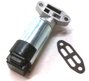

MCS-8 Ford 1 Barrel YFA Pulse Solenoid 1983-86 Ford & Mercury 4 cyl., 1983-84 Ford Truck 4 cyl.
The Holley 1-bbl 6145, 6149, 6153, look the same as the YFA Feed Back Carb, but are not the same, and don't have the Mixture Control Solenoid.
Ford's generic 4 cyl 2.3 OHC replacement part is
E4PZ-9S565-C
Walker 318-2006 still supply it
Its Standard Motor Part MX-33
"http://www.ebay.ca/itm/Standard-MX33-NEW-Mixture-Control-Solenoid-FORD-MERCURY-1983-1986-/282029461641"

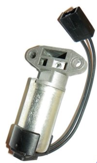

MCS-9 Ford 1 Barrel YFA Pulse Solenoid 1983-86 Ford Truck 6 cyl.
No longer serviced, they say.
But its around! Standard Motor Part MX -32
"http://www.ebay.com/itm/Mixture-Control-Solenoid-Standard-MX32-fits-1983-Ford-F-150-4-9L-L6-/162474041769?hash=item25d43521a9:g:0hIAAOSwjDZYmbf0&vxp=mtr"
