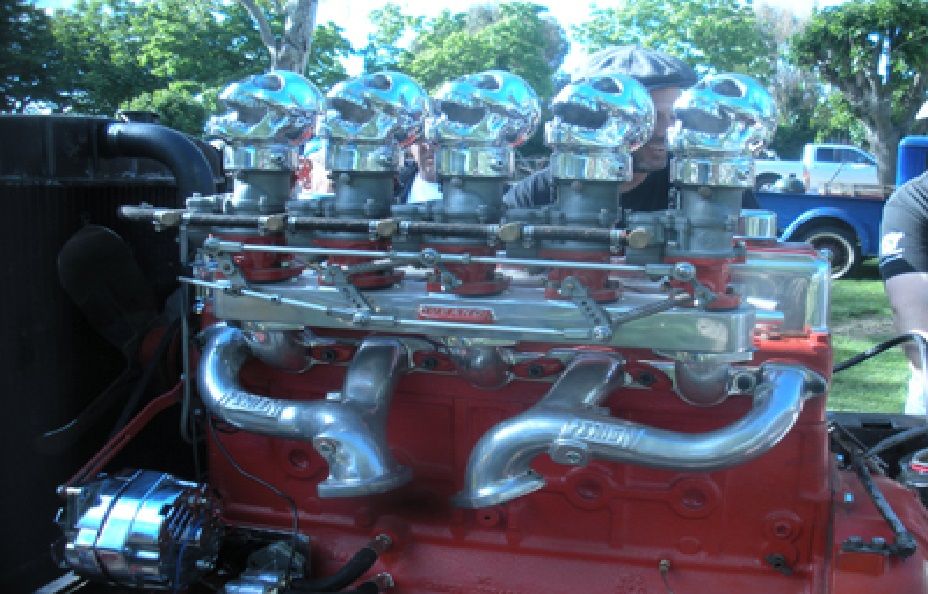

1-1/2 venturis per cylinder (12 bbl's of Six Deuce Stromberg 97's on a stroked to 352 cube "283" Chev V8),
By 1967, he was doing side draft twin SU

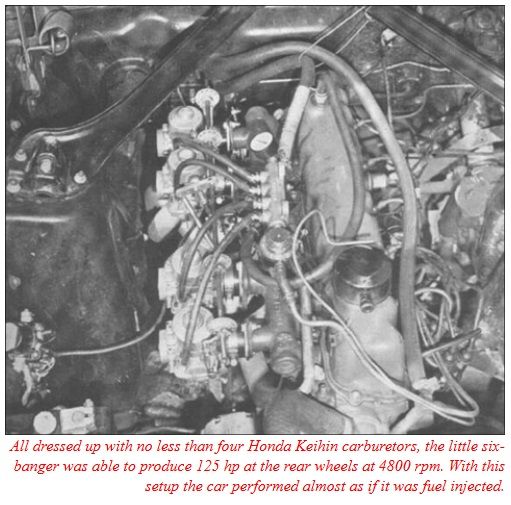

and four carbs per six cylinder (Four Keihn 37'son a 200 Ford Six),
Back in the 50's and 60's, the Chevy guys were doing it too

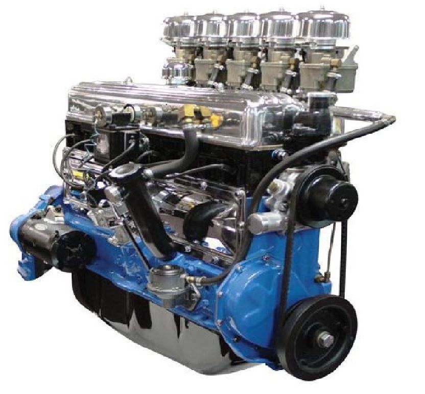

5-bbl GMC 302's
and 5-bbl Chevy 250/292's run five bbl carbs on there L6's.
