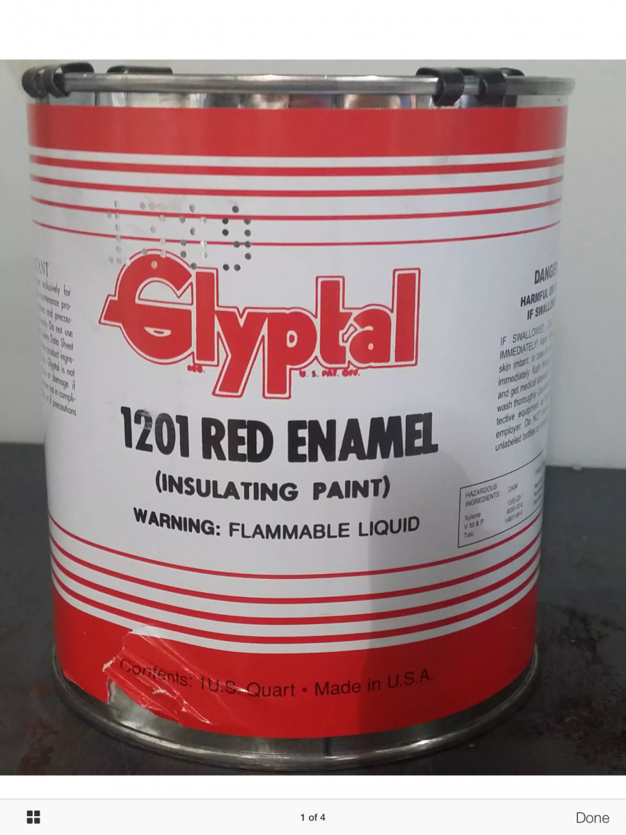

If its been rebuilt, a good engine builder will use Glyptal 1201 to cover the inside castings so they don't leach sand. After hot tanking again after a remeachine, the painted internal surfaces are baked for a couple of hours. Done right, it sticks like teflon to a De Loren, or like Schtuck to a blanket
image-png.3268480
Its done mostly on Ford engines, and the chemical is used on electric motor reconditioning. Ford engines suffer more than most from oil windage with revs, Glyptal 1201 helps with that too.
