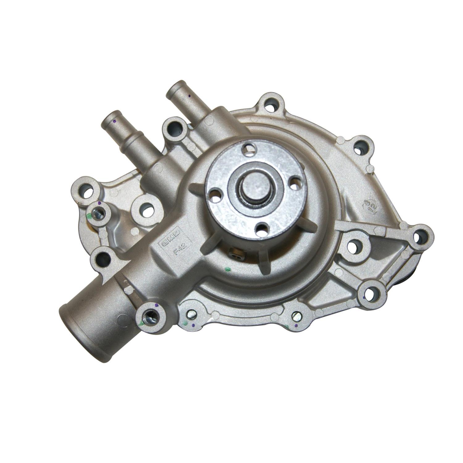

I am looking at buying a water pump as well....Where do you purchase a "high volume water pump." I am guessing that this helps keep the engine cooler? Right?
From what I remember from my research is that if you have a stock engine a double roller is not really required. When I replaced mine I just did a stock replacement. I would tend to have the same philosophy with the oil and water pump if you are running a stock engine and don't have any oil or over-heating issues.
I understand a small increase is not harmful or real helpful. Stock is fine: Some here suggest the GMB pump. Heres 1 for the 289, look it up for ur motor:
cavitation would B a concern.
