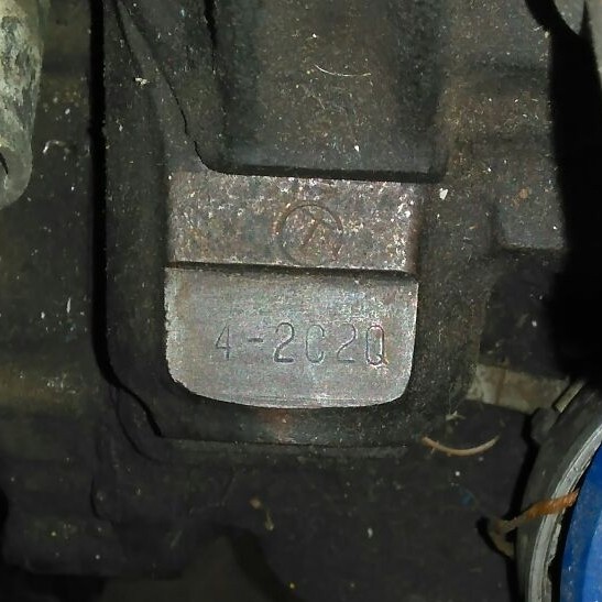

Easiest way is to look on the top of the road draft boss. It's on the front drivers side corner, top of the block. Clean that off with some brakleen and a wire brush. It will either have a T or an N stamped into it. If it has a T it's a 170, N = 144. It's that simple. If it doesn't have an N or T there and it's a 3 core plug block it's a 170 or maybe, but unlikely, a 4 main bearing 200.

Btw afaik, the only code on the passengers side is the one on the head and you certainly can't trust that one to tell you what your block is. The block casting code is on the drivers side between the coil and the oil sender port. The only thing you can trust is the letter stamped into the road draft boss, or pull the head. They may have moved that tag from the old 144 to whatever is in there now when they swapped the coil over. I had a similar situation with my 64 Econoline, vin tag states 144, blue valve cover But the previous owner had been told it was swapped to a 170 sometime before he got it 25 years ago. I thought I may have had a 144, but after cleaning off that boss down to the metal there I found a T in a circle.
Here's a picture of the actual stamp on my 170 block:
You just never know with Ford, it's crazy. I'm curious if your distributor is 1/4" or 5/16" drive? I'd bet it isn't a 144. Mine was a C2 block casting iirc. It had a 1/4" drive oil pump and solid lifters.

You might go after that upper area on the road draft boss with a chisel, brush and some solvent. It looks like there is still some crud there. I didn't mention I cleaned mine once and didn't see it the first time. It may just be my eye's or the lighting, but I can vaguely make out a circle there where mine was encroaching the ledge near the machined bit in your pic.
