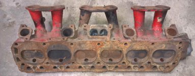

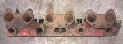

Next up are the 40DCOE Webers that were on the Triford when I bought it. Note the more traditional style linkage arrangement, which apparently is harder to synchronize at throttle positions between idle and full throttle because there may well be any number of components that are not perfectly straight/even/unworn etc. At least this is what the Weber expert told me...

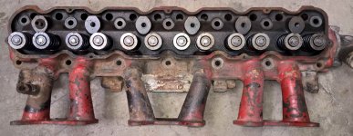

Here is what we believe to be the original head (I have photos taken in 1972 of the original build and while they are not as clear as the ones I'm posting, they do show the head looking very much like this and in far better condition):
I've mentioned the valve cover and not shown it - so here it is with the engine on a stand:
I hope this helps or at the very least entertains!

I'd love to go out there and see a historic race car like that in person! However that's in the far future.
Also no worries on the engine looking grubby, I totally understand it not being a show car. It's used, it's fun, it serves a purpose other than looking pretty!
I'm gonna try and get another log head and modify that instead of my original which is still on the engine. I'll probably cut off the log and either weld or make a custom removable intake manifold.
Thanks again for the pictures! Cheers!
- Andrew
Thanks so much for pic
AND
story! white intake looks alill like the Lynx (somewhat avail Down Under).
Red: many of us DYI could do...a machine shop (or equip.) would assist quite nicely!
