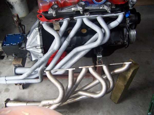

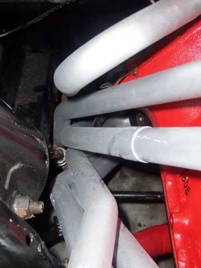

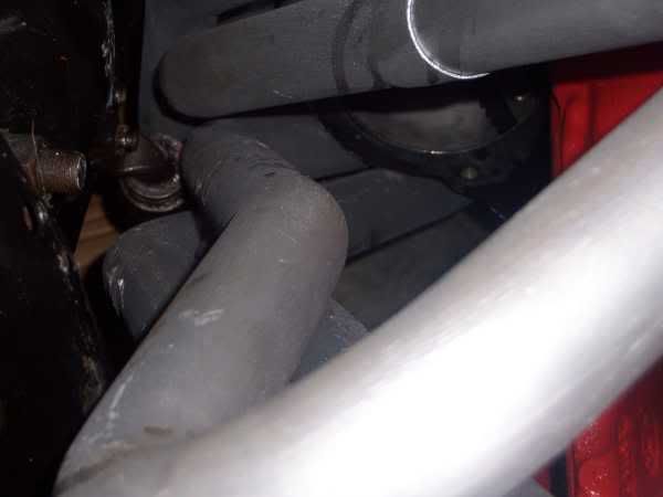

The unidentified long tube headers don't look like they could clear the shock towers and steering in any early Ford passenger car. The Hooker 6602 longtube's needed some BFH to fit in the '61 and looks like the UN_ID's ones are even more spread at the exh. manifold height.
Interesting ...
..Image .
Hooker 6602 on 250 with 6601's next to..
from above at shock towers
