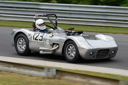

Seems non-intuitive but I was at a sports car - track car garage recently and the main mechanic was explaining the physics behind additional friction losses with 3 more bearings and reason for four main sixes revving higher than seven main. I was there consulting on front suspension mods for a 65 Mustang Fastback being built for race track with class restrictions .
Conversation centered on my opinions on the Fastback's conversion from six cylinder 170cid grocery getter to full tilt racer and the legendary Falcon six powered "Philson Falcon". a purpose built track car with a Ford 144 six layed over like a slant six and supposed 9K rev limit.
Built by machinist and USAC tech inspector Norbert Philson in 1959, the Philson-Falcon features a tubular ladder frame of Philson's design and a considerably reworked Ford Falcon six-cylinder engine fed by three SU carburetors. The special is owned by Charles Bordin of Scarsdale, New York.
very interesting -anyone got a photo of the engine /engine bay ? my gooogling didn't turn up anything
got a pic of other side of the engine? like the intake!
wonder Y the solex.s Coulda had anything I imagine...
And Y the 'slant' ford6? Did they say just for space?

The race car pictured was run before the 7 mains came out. So thats all they had then.
