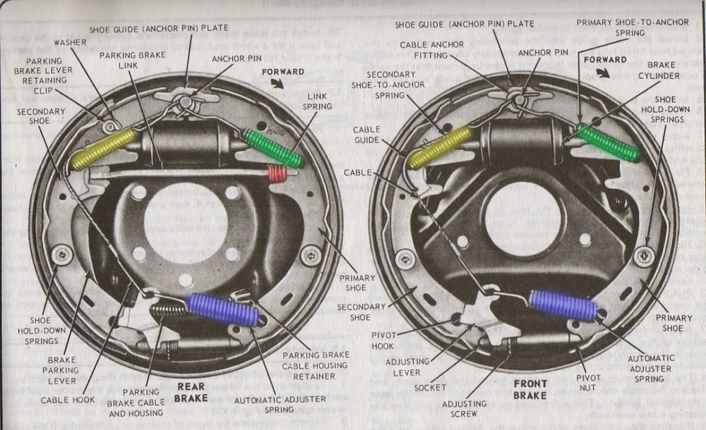

Remember the two sides are a mirror image. One pad is longer than the other and one of the adjusters is left hand thread. Keep the fwd arrow in mind.
Use anti-seize on all contact points, like the spring lands, the pads on the backing plates, threads of the adjusters ect. If the pads on your backing plates are grooved, file them flat. If they are really thin or worn near through fill/build them up with weld then file them flat.
