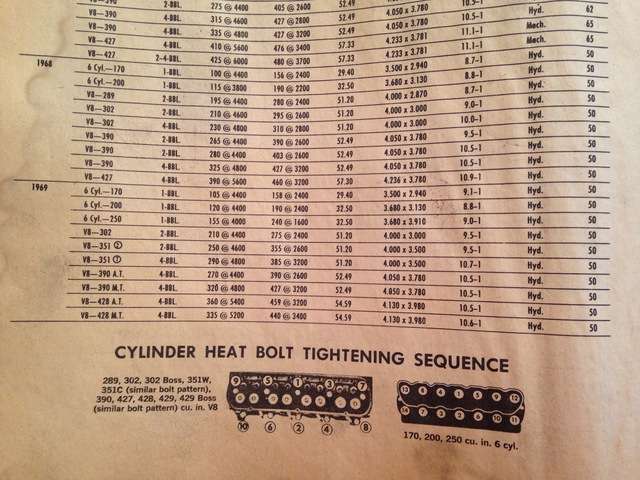

Is there reference info available:
Factory Rated HP and TQ @ X RPM.
Curious about RPM ratings 200 vs 250
I know change in HP ratings in early 70's confuses issue. '69 Mustang 250 ratings ?.
thanks

Is this what you're looking for? torque is 240 hp is 155
I have seen those specs like in the shop manual 240 torque and so on. Pretty sure the marketing department came up with that.
thanks, this is the page I needed for considerations in forced induction mods.
