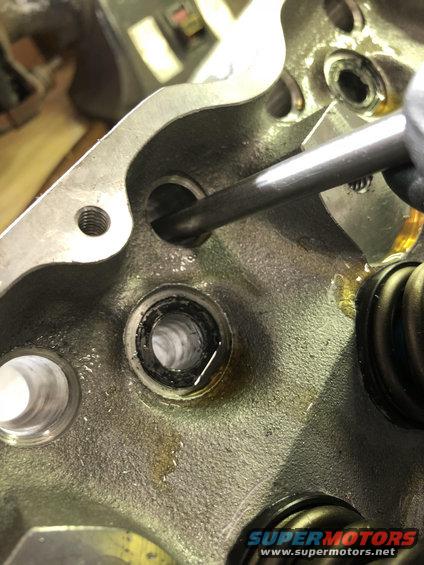

So finally got around to making clearance for the push rods, I already had the head off but in the first picture this is what the rod looked like when it was making contact.

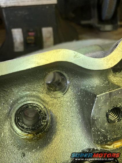

I should've disassembled the head before grinding to save myself the extra cleaning hassle. I ended up having to take more away than this next picture shows. Some of the bores ended up not needing much at all but a couple I almost went halfway down the bore.
