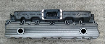

I have a '69 M-code head sitting in my garage awaiting modification, and have a couple questions:
1) With the large flat intake on this head, will there be low spots that need "filled" like the hex heads when doing the 2v conversion? Example photos from tech archive below...
2) If I upgraded to the 1.75" intake valves, will that require modification? Worth it?

Howdy 65 Stang:
Q- With the large flat intake on this head, will there be low spots that need "filled" like the hex heads when doing the 2v conversion?
A- Probably not. Less filling for sure, if needed. It will also depend on which 2V carb you use and which adapter. Also, head castings vary on internal dimensions.
Q- If I upgraded to the 1.75" intake valves, will that require modification?
A- Probably not, but check carefully to make sure the 1.75" intake valves clear the smaller bore of your 170. Also be sure to use a 200/250 head gasket on assembly.
Q- Worth it?
A- I would say yes. How much? Well that depends on other factors in your engine build.
In addition to larger valves be sure to add a back-cut to the intake valve regardless of which intake valves you use. FYI, 1.75" intake valves became standard from the Ford factory on all six cylinder engines in the early 70s. If FoMoCo thought they were worth the added expense that is a good indication of their worth.
Q- Does the 1.75" refer to width?
A- Yes, the width across the face of the valve head.
I'll be interested to hear your other plans along with a new cam. Compression ratio? cam specifications? what rear end gear ratio?
