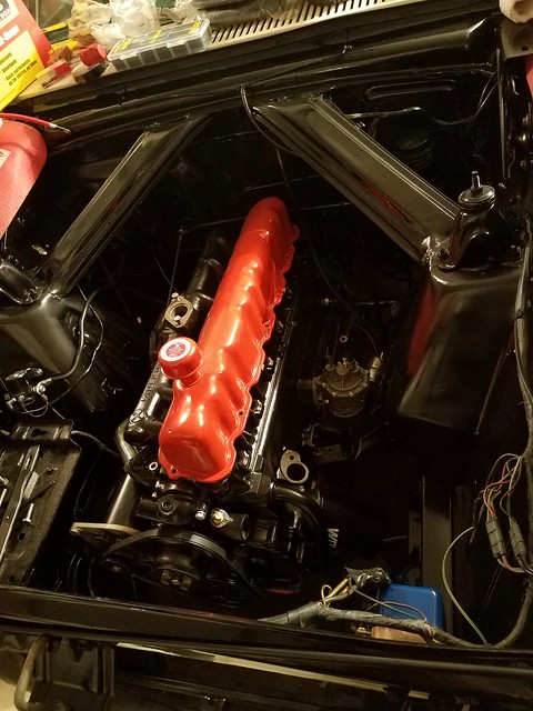

Any pic of it on 'our' engines?

...just 1 pic is all I ask...
I understand they stuck ouda da side'a da block?
Musta been the right/passenger's side?
62Cometman":2u4ris01 said:
Drivers side actually, let me see if i can dig up a picture of it on my block
Oh, yes, that would B real nice, thank you.

Never saw the i6 with that large boss cast into the block up high like that (or anywhere else).
Nope, nevah!

Frozen beat me to it but here it is on my car from what i know up until they started using and actual PCV system all the small 6 blocks had these on them, so my guess is like 65-66? probably somewhere in that time range.

I can just make yours out.
Looks closer to the head & a lill more squared off frm that angle.
