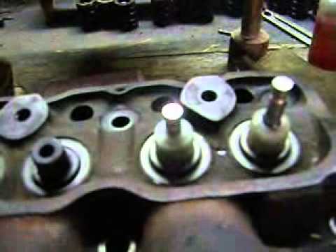

Hello! How are you? I'm from Argentina I'm very sorry if I do not explain well haha ​​..
The blue exhaust smoke and an oil consumption. It can be transported to the "valve stops" (I do not know how it's said in the United States, I think the valve seals, I'll attach a photo so they know what I'm talking about) are usually dry or broken for years, the oil It filters in the camera.
a reconstruction of the cylinder head would be enough.
retenes-de-valvulas-de-tapa-de-cilindros-de-ford-falcon-D_NQ_NP_459425-MLA25451942347_032017-O.jpg
