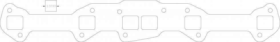

I have a CAD file for a small 6 exhaust flange. Forum won't let me post a .DWG or .ZIP file. Maybe I can send in private message to anyone that wants it.
I've had 2 CNC plasma cut locally in 3/8" steel, bolt holes line up to head, bolt holes and ports are slightly undesized, drilled to clean up plasma cut taper. Very close on exhaust ports, flange should be ported to match head plus tubing thickness. 1" square scale reference in drawing, Center ports are set up for a port divider.
This attachment is just a .JPG, not the actual CAD file.
