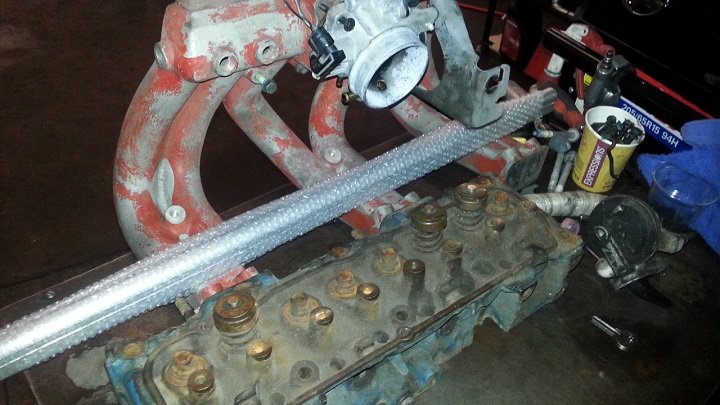

Another 4.08 inch bore center engine was the 9 and 12 port Holden 2.8 and 3.3. They injected the 3.3, and also loped two cylinders off to become the famed Holden Starfire 4 and Phase 2 XT5 1.9 four cylinder.
The port phasing was odd on those.Here is a four cylinder Holden 1900 with the 3.3 liter six cylinders EFI intake on it.
Ports are like this.
The American Erika HSC is mapped out a differnt way.
