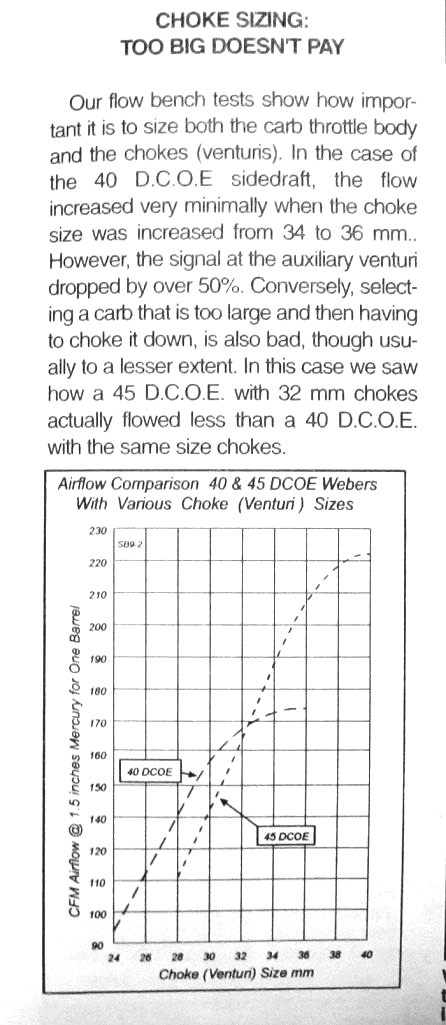

Should I be on the lookout for Weber 40s instead of 45s? Based on the charts and programs above, the calculations point to Weber 40s with a 33mm choke. Isn’t it true I can get the 45s in a 33mm choke as well?
As hard (and expensive) these DCOEs are, there seems to be much more 45s vs. 40s available.
Go for DCOE 45's if your using 33 venturis. Less than that 42DCOE's, which are ideal for 33 mm venturis. Maserati really did the most excellent work on DCOE's in the early 60's. 42 DCOE's aren't very common. In the USA, thankfully, 45DCOE's predominate, and thats just great because even a 2 liter Pinto runs better with 45s than 42's or 40's.
Biggest issue is the problem with the low venturi gospel. You
never want to downgrade venturi size unless the graphs for your cylinder size and rev range say you can. If you ignore the advice which streams from Edaurdo Webers WWII areo tests, and fall prey to the "it'll run better with smaller venturis" brigade, you'll be in for heartache.
An independent runner system on a 6 cylinder car (triple DCOE's) needs to have the venturi size exactly right for the application, and the carb size (40, 42, 45 or, gasp, 48DCO, 50DCO, 56DCO etc) has to fall in line with the venturi size.
Going down in venturi size if your DCOE45's come with, say, 38 or 40 mm venturis is fine though, if your 200 is only going to make power at 5000 rpm, and maybee over rev to 5500. 33's will run real nice everywhere in the rev range if the ignItion advance is as great as the carb tuning.

If this 300 six makes peak power (maybe 250 hp) at 4500 rpm and will rev limit to 5000 rpm, what would the ideal venturi size be?
If the present Weber 45 DCOE with 36mm venturi are used at what point would you expect power to be sacrificed?
Thanks for your input.
For a 300 in line six, its 819 cc per cylinder.
I get 40 mm from the graph for power at 4550 rpm, Thats about the biggest venturi you can get in a DCOE45.
The calculation variable for 819 cc per cylinder is Critical Flow condition. An Air restrictor would be Venturi meter with Cd about 0.85.
As the venturi to carb size gets more divergent, the Cd figure goes down, becoming more streamlined, and you get a hp and torque gain from it.

I get 43 mm at 5500 rpm, and the black line is for a 36 mm venturi on a 300 six, about 3600 rpm.
Way too low for a 300 cubic inch six with 819 cc per cylinder.
3600 rpm with the 36 mm venturi is a huge restriction to the elastic rev range required to run an IR system, and conventional US multiple carb logic doesn't work unless the air speeds are dropped.
CFM is a truley bad way of rating a multiple carb installation on a 300 cube six.
Although the flow losses of the 45 DCOE will flat line well below 36 mm, the losses between 38 to 40 mm are huge on a DCOE 45
Its better to find a set of DHLA 48's or 48DCO's or downdraft IDA 48's to get a better flow rate.
At the end, though, Aston Martins and Charger E49's used 40 mm venturis in DCOE 45's and they worked great on 314 to 325 hp 4 liter Hemi DOHC and 302 hp 265 cube Polyspheric OHV engines. The same thing happens with 38 to 40 mm venturis in 45 mm carbs, they become a lot more restrictive than 38 or 40 mm venturis in 48 or 50 mm carb bodies. Your loosing flow.
If your breaking the budget just to get an independent runner Triple Weber, then the only thing important is the venturi sizing. You can comprimise on air flow....Aston Martin and Chrysler Australia did, and those DB6'S, DBS's and Six Pack Chargers sang like Italian or Spanish tenors at 6000 rpm, 500 rpm past the point of maximum power. Because the venturis sizes were bang on, even if the carbs were techncially too small compared to some 48's or 50's. The extra cost in bigger Webers or Dell Ortos is just massive....

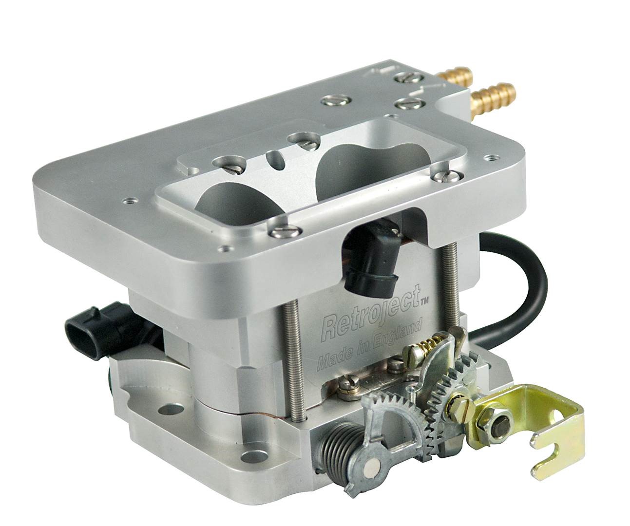

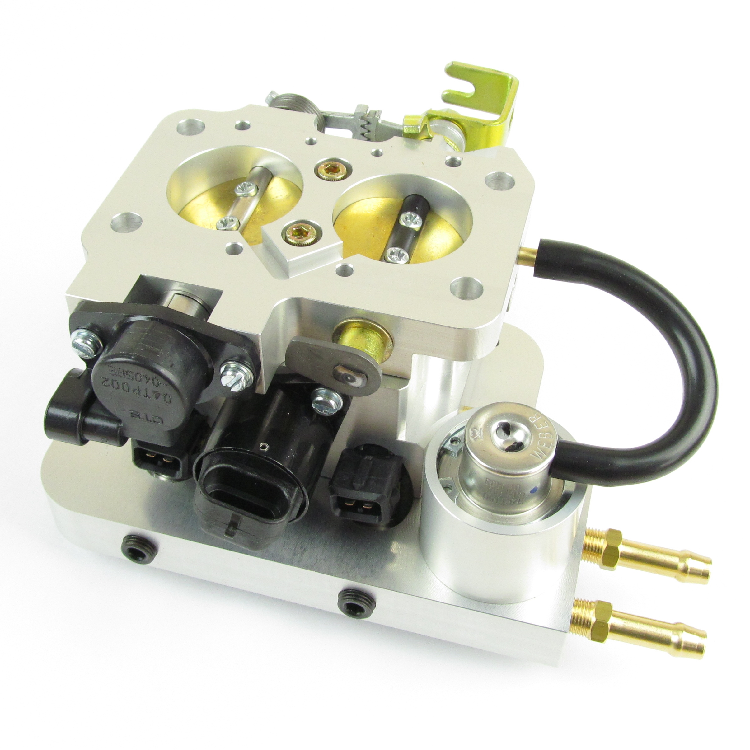

Retroject 38/38 Throttle Bodies
and Jenvey's DCNF TC body 40-45mm
[ TC42i TC body 42mm. DCNF - Bosch EV1 / EV6 (long 64mm between 'O' ring centres, 14mm boss)]
the above are much better bets.
Don't use ATB or Jenvey's ECM's, use a USA MegaSquirt computer, and see FOX Engineering Co, and save all the heat soak and tuning hassles, and forget all the sizing issues above.
About U$ 1200 for three 42 mm ITBs, aiming for 255 hp at 5800 rpm is very possible.
