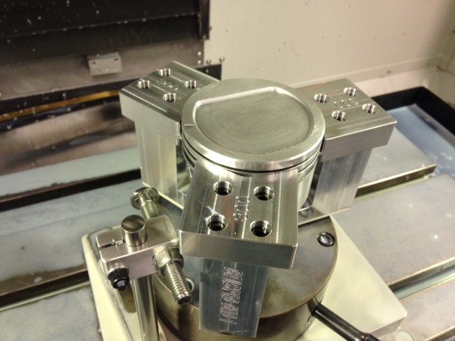

Ecconoline had his 2.5 pistons with 90 thou wrist pin offset machined to 12 cc.
