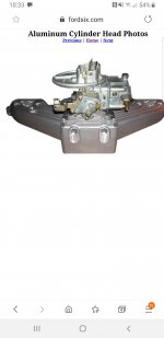

Hey guys quick question... What are these two holes for and do I need to plug them off?

Its where the heater hoses connect to prevent carb. icing in cooler climates.
In southern areas you could hook up a cooler with a pump to reduce the temperature below the carb.
