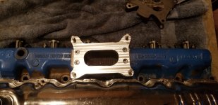

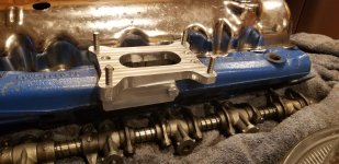

Attached are photos of a an EOBE cylinder head that is being sold in my localish area. Guy is selling this head with a number of other items. I have a 79 200 in my car, I’m looking to do the machine work from the manual to my cylinder head this fall. With the extras; cam, carb, HEI distributeor it seems like a viable shortcut.
I have no experience as to what a well machined head should look like. Can the forum experts please take a look and tell me if this at least looks good.
Specifically the 2 barrel carb flange, the valves, retainers, chambers and the valve train.
At least visually it looks to me that the rockers and valves don’t fit properly. The tips don’t line up with the centers of the valves or cups with the pushrod holes.
Any help would be greatly appreciated.

:beer: congrats that head looks great to me! :thumbup: :nod:

Yeah some of those rockers look weird.
Perhaps they can be pushed into alignment?

It looks like a very nice modded head to me as long as there is no cracks.
The placement of the adapter is good and you could blend the old bolt boss if you wanted to.

"...Esp around the center, 3 & 4, exhaust valve seats. It looks like they did a good job with the 2v..."
agreed.
U could add the exh port divider if going 'tubes', 'pipes', 'headers'. It maintains the gasket'n directs the gasses better than w/o. 0 - minor HP/tq addition.

JackFish wrote:Yeah some of those rockers look weird.
Some of them are tipped back

Right on man! Looks like you're set up for a weber. I set mine up for a holley/autolite on my E0 head.
What did the guy do for a cover for the EGR part of the intake? Thats where mine has the aluminum plate on the side

If your 200 block is zero decked & with the head combustion chamber cc's @ 50 & with the small dished piston's you will have close to 9.5 compression.
The carb adapter is very nice, being machined at the correct angle to keep the carb level.

Post #27 by StarDiero75 » Wed Aug 07, 2019 3:02 pm
xctasy wrote:
StarDiero75 wrote:Right on man! Looks like you're set up for a weber. I set mine up for a holley/autolite on my E0 head.
Normally, its done like this.
Factory late model replacements have the EGR hole Allen key/Cap screw plugged. The B VIN code E0 casting head was used late in the D9 model year on some T codes
They make a plug for it? I can't thread mine since the clearance is pretty slim between the top of the hole to the carb adapter mounting surface. I think I'm looking at .070, and i don't feel comfortable tapping that. Unless its tapped in...

Post #31 by StarDiero75 » Thu Aug 08, 2019 1:47 am
I made me a hand made plate out of aluminum. The problem is that when i milled for the 2bbl, i had to go down pretty far to get a decent sealing surface. Which gave me a super thin area from the milled surface on the log to the EGR port. I think its about 70 thousandths in gap between the 2. Should that be an issue sealing it? Or am I better off JB welding a plug in there or something? Or just use a cut my own paper gasket stuff?
I was thinking about drilling a hole and tapping my plate for .25" NPT so i could have another vacuum port rather just the one on top of the log. I might add power brakes in the future and figured it'd be nice to have that option.

200 Cylinder Head (LOG) Machining Opinions
Post #32 by chad » Thu Aug 08, 2019 1:23 pm
if there's enuff 'meat' (area frm 'hole' up to newly milled surface for carb/adapter) obviously go fer a plug system.
Plenty of cutting fluid'n a nice tap, back'n frth rather than just straight powerin thru, make straight enuff to put sompin in that will not B crooked'n hit adapter. Plan the 4 or 6 point head so as 2 B able to wrench. But some planning 1st.
One of the rules on machinin is "sequence of operations'. Lota of planning 1st, Do Not pick up the tools B4 the whole
system is figured out. This would have been a 1st not last step. Anyway, there's wrk-a-rounds (may B).
The planning here is "What sz hole/treads do I need for what sz plug such that I can remove later'n insert a useful tap/nipple?"
"PPPP" is it: proper planning prior to production?
Again, Y go thru alota head skratchin after (& may B no solution) after when it wrks beddah B4?
Keep talkin, we're here...
