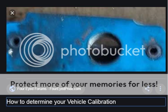

StarDiero75 wrote:Right on man! Looks like you're set up for a weber. I set mine up for a holley/autolite on my E0 head.
What did the guy do for a cover for the EGR part of the intake? Thats where mine has the aluminum plate on the side
In non emissions places like UK and New Zealand, its normally done like this with a steel plate, two bolts. The hole is still open here, this is a plate spacer.
Factory late model replacements have the EGR hole Allen key/Cap screw plugged.
The B VIN code E0 casting head was used late in the D9 model year on some T codes...Ford were planning and like the 1965 IRS suspension Mustang, even documented a 2BBL 3.3 for 1979, but opted to do a 255 2-bbl 120 hp V8 for 1980 instead.
this item below an XE stamped factory 100% correct experimental head with the eventual E0 spec 2-bbl EGR and casting variations planned. Everything has Fords engineering numbers etched in. Dead easy to block off the EGR.

Post #27 by StarDiero75 » Wed Aug 07, 2019 3:02 pm
Normally, its done like this.
Factory late model replacements have the EGR hole Allen key/Cap screw plugged. The B VIN code E0 casting head was used late in the D9 model year on some T codes
They make a plug for it? I can't thread mine since the clearance is pretty slim between the top of the hole to the carb adapter mounting surface. I think I'm looking at .070, and i don't feel comfortable tapping that. Unless its tapped in...
--1965 Ranchero w/1966 200, dual friction diaphram 9" Modern Driveline clutch and billet flywheel all balanced, 1985 SVO WC T5 with front shift, 1966 2.8 Ford 8", Weber 32/26 with VI adapter, CRT Performance HEI.

xctasy wrote:
ponikorjaamo's EGR was blanked off
So they
1. swapped the postion of the vacuum tee, and
2. got the integrated EGR port which was another reason why the volume increased.
3. The casting was optimised to suit the emissions targets, and the first changes were the two mods above.
[code][/code]
For 1980 to 1983, man vac (Item 17 on my VECI list) is on a hex port, capped off with a hex grub screw in 1bad6t's photos
http://1bad6t.com/Extra2/14-E-BE-BB.jpg
http://1bad6t.com/Extra2/intake-boss.jpg
Posts: 6946
Re: 200 Cylinder Head Machining Opinions
Post #29 by xctasy » Wed Aug 07, 2019 3:24 pm
1. Blank off the EGR by removing the whole valve, and place one of these hand made metal plates over it. Use the existing gasket as a template to seal it.
This how the 1976 yo 2004 New Zealand market Australian 3.3 and 4.1 liter cars with EGR were "de-emissionised"
For service items that weren't used in full emissions cars, Ford US supplied Allen Key/Hex headed "grub screws" to cover up non functional manifold vacuum ports.
Like Ford New Zealand did
These come in various sizes, and you can use them if you wish.
Here is the brilliant Luke76 (He has sensational write ups on the emissions parts for his F150 truck, 1980 258 AMC Jeep), and who has a Granada with 250 engine, same cylinder head. The vacuum tee is capped off like .
His pictures don't link know tho....
Other side of the engine, also down to bare metal, ready for paint.
Engine after applying a coat of POR 15, then a second coat of engine enamel (the color coat). I still need to paint the top of my dipstick white. I didn't paint the head because it is going to be replaced anyway.
One of the many accessory brackets as it came off the engine.
Same bracket, cleaned, treated, and painted.

Post #30 by xctasy » Wed Aug 07, 2019 3:39 pm
This is 1bad6t's, from the Maverick forum, saved on the FEP Emissions calibration pages.

Post #31 by StarDiero75 » Thu Aug 08, 2019 1:47 am
I made me a hand made plate out of aluminum. The problem is that when i milled for the 2bbl, i had to go down pretty far to get a decent sealing surface. Which gave me a super thin area from the milled surface on the log to the EGR port. I think its about 70 thousandths in gap between the 2. Should that be an issue sealing it? Or am I better off JB welding a plug in there or something? Or just use a cut my own paper gasket stuff?
I was thinking about drilling a hole and tapping my plate for .25" NPT so i could have another vacuum port rather just the one on top of the log. I might add power brakes in the future and figured it'd be nice to have that option.

Post #32 by chad » Thu Aug 08, 2019 1:23 pm
if there's enuff 'meat' (area frm 'hole' up to newly milled surface for carb/adapter) obviously go fer a plug system.
Plenty of cutting fluid'n a nice tap, back'n frth rather than just straight powerin thru, make straight enuff to put sompin in that will not B crooked'n hit adapter. Plan the 4 or 6 point head so as 2 B able to wrench. But some planning 1st.
One of the rules on machinin is "sequence of operations'. Lota of planning 1st, Do Not pick up the tools B4 the whole
system is figured out. This would have been a 1st not last step. Anyway, there's wrk-a-rounds (may B).
The planning here is "What sz hole/treads do I need for what sz plug such that I can remove later'n insert a useful tap/nipple?"
"PPPP" is it: proper planning prior to production?
Again, Y go thru alota head skratchin after (& may B no solution) after when it wrks beddah B4?
Keep talkin, we're here...
