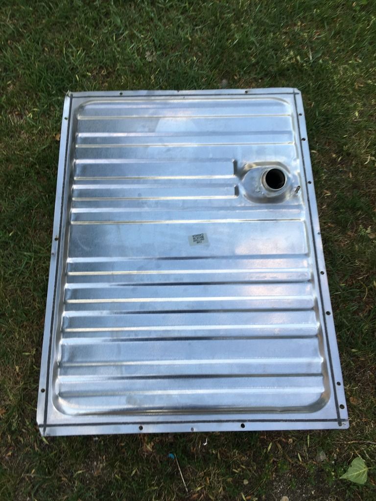

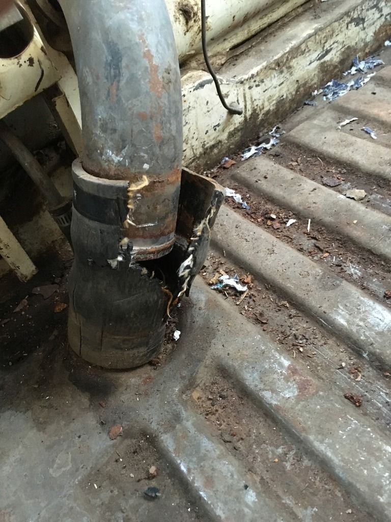

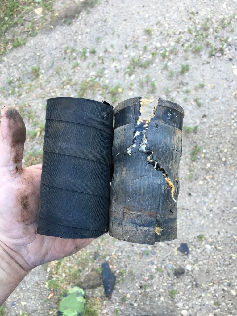

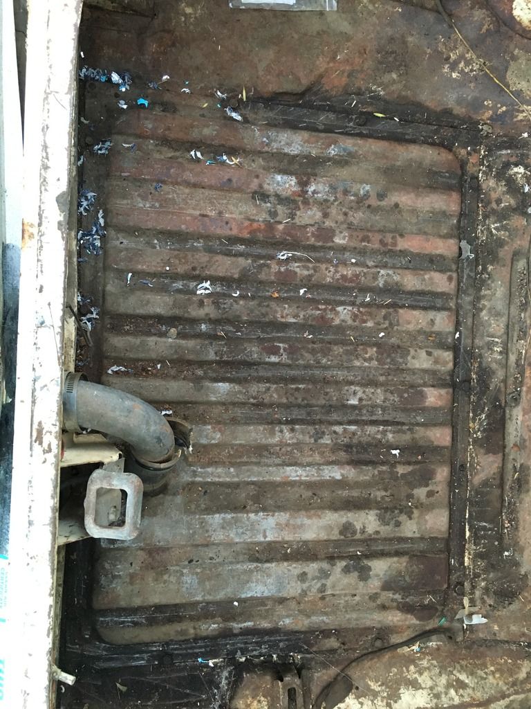

The old tank needed to come out.
The old connector hose was dry rotted garbage, I split it open with a flat nose screw driver.
I bought some 2" fuel filler hose and cut a new one.

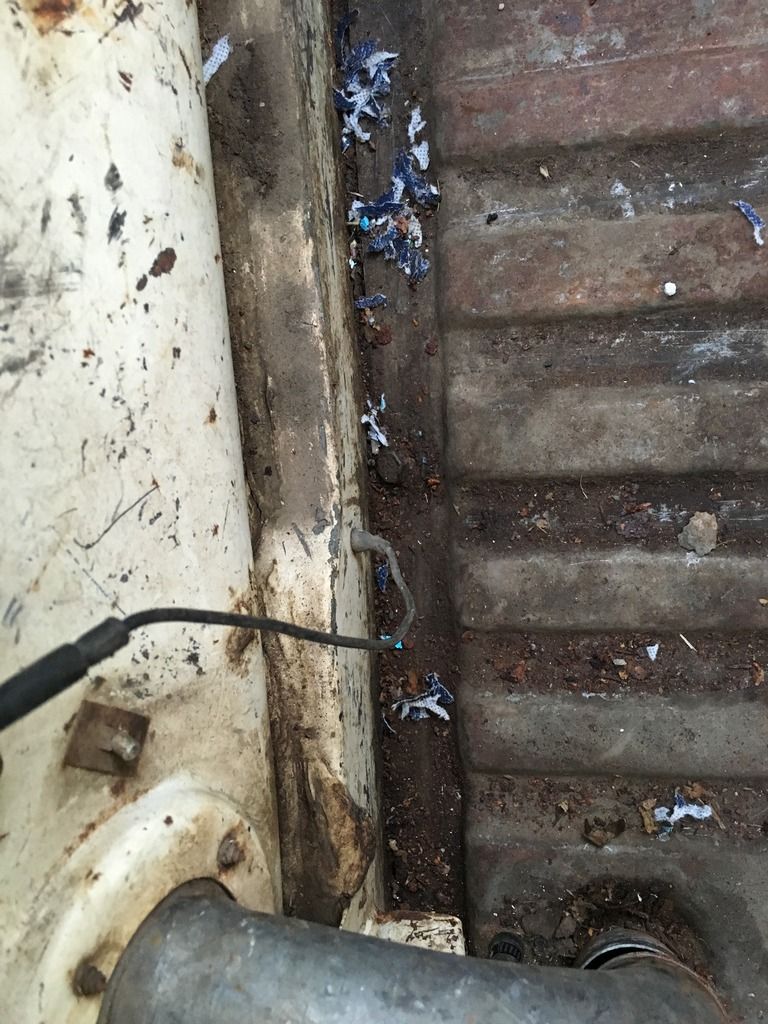

All the bolts came out easy with a socket on a drill/driver.
Except this one, it had to be wrenched out.
Tank all the way out.

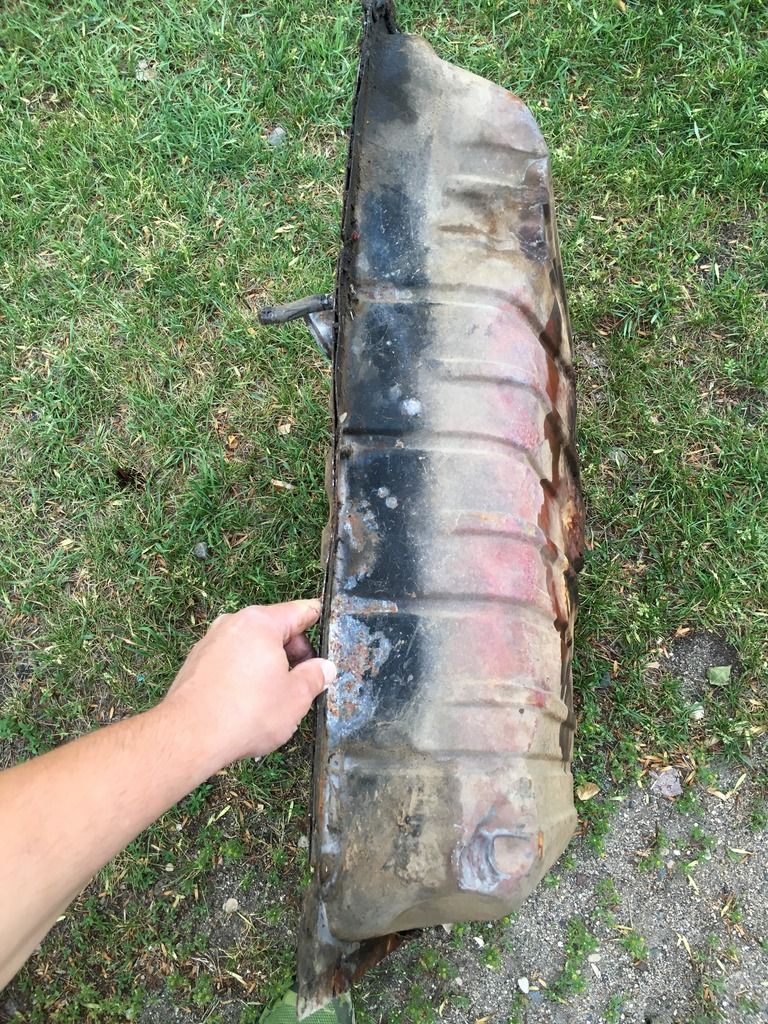

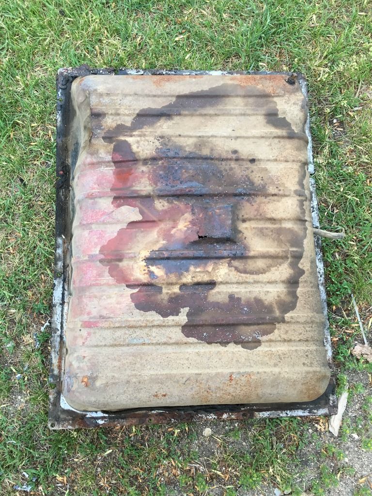

And at the bottom you can make out the problem.
Holy Gas Tank Batman!
All dented and multi-colored

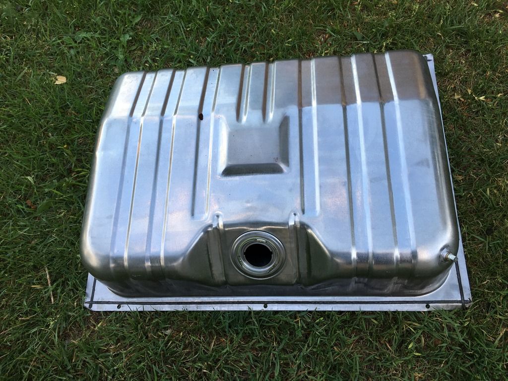

New Shiny from the top.
And bottom

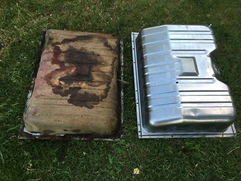

Side by side on the bottom.
The old tank is 14 gallons, the new one is 16 gallons.
These are the major players of new parts.
Both the tank and the sending unit each came with their own locking ring, I used the one that came with the tank.
New 3/8" fuel injection fuel line and clamps on the bottom.
New hose up front too
I dumped in 5 gallons of fresh gas and drove around the yard and gravel road for sufficient time to ensure it is pulling from the new tank.
The fuel gauge barely went above empty, even though it should be close to 1/3rd full. Hopefully I can rule out the sending unit.

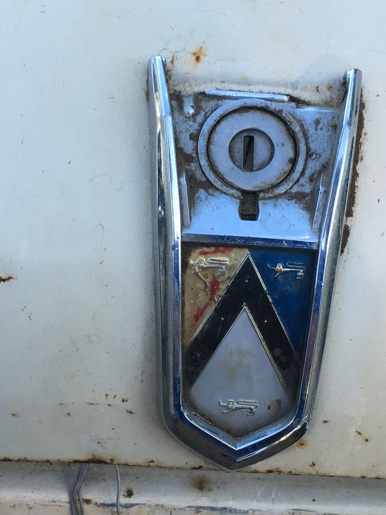

Trunk/decklid lock.
Its a puzzle that I have no picture of.
And I'll have to order a key/tumbler for it.
I don't have to find a new one of these, but I'll keep my eyes open for one in better condition.
I've been wiring it shut to keep it from flapping.

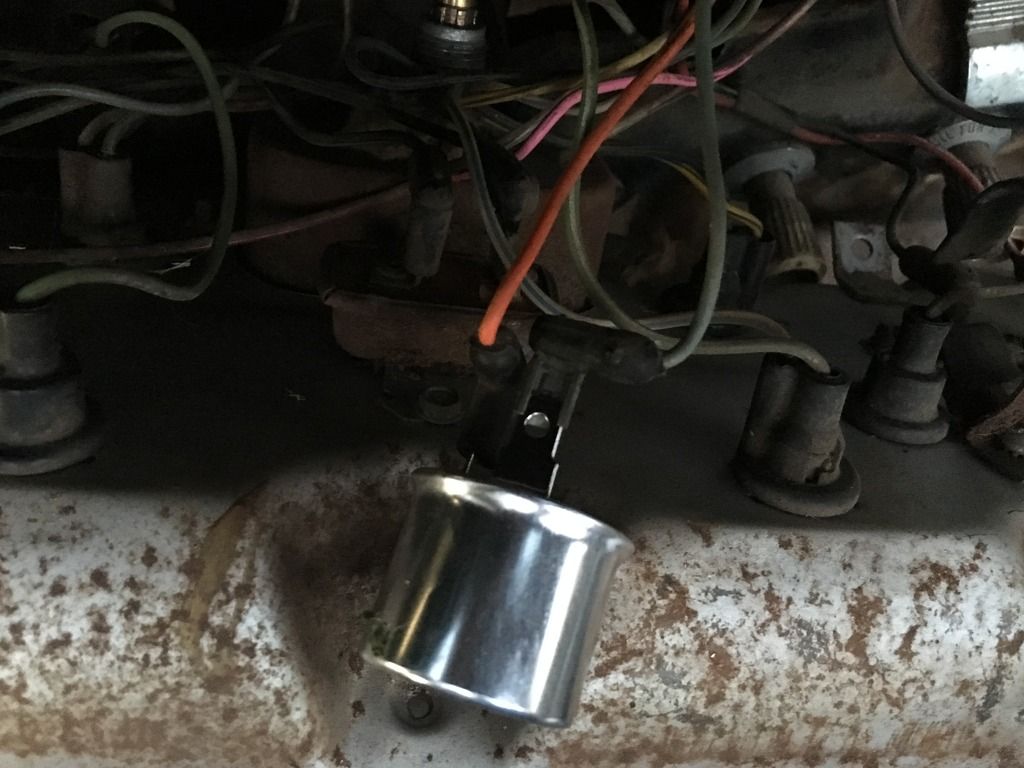

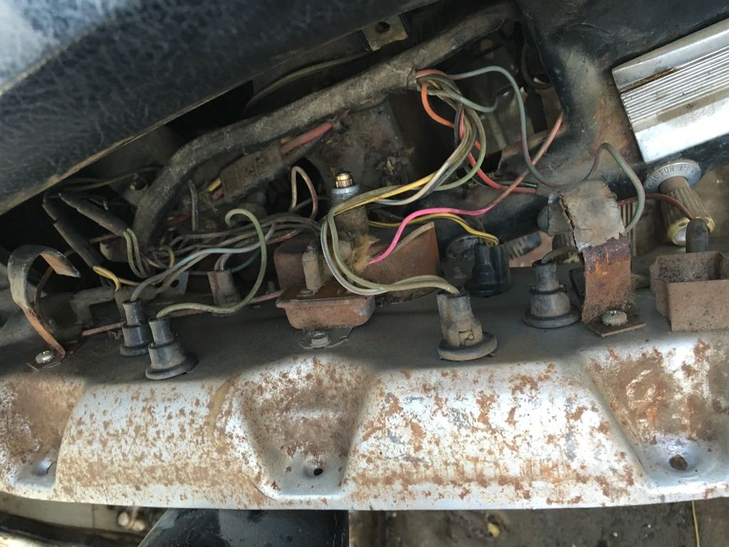

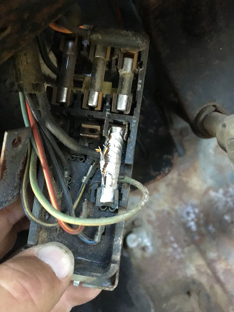

After not finding the flasher, I pulled the dash/gauge pod.
And then still not finding the flasher, I pulled the light switch.
No flasher, but I did find an interesting fuse.
Then one of the guys on the Facebook Ford Falcon Online Group (FFOG) said that it should be plugged in to the right side of the dash in a clip that is empty, and that I should look for an orange/yellow wire that is hot while the key is on. I found it and plugged it in to one side of the flasher, then found another wire (purple) and plugged it into the other side.
And presto! I have a blinker, only the driver side, but no tail lights or brake lights.
For those, I rememberd that I had pulled the wrapped fuse out and hadn't replaced it yet, so I plugged in a brand new 20amp fuse and now I have tail lights (both sides) but only blinker and brake light on the driver side.

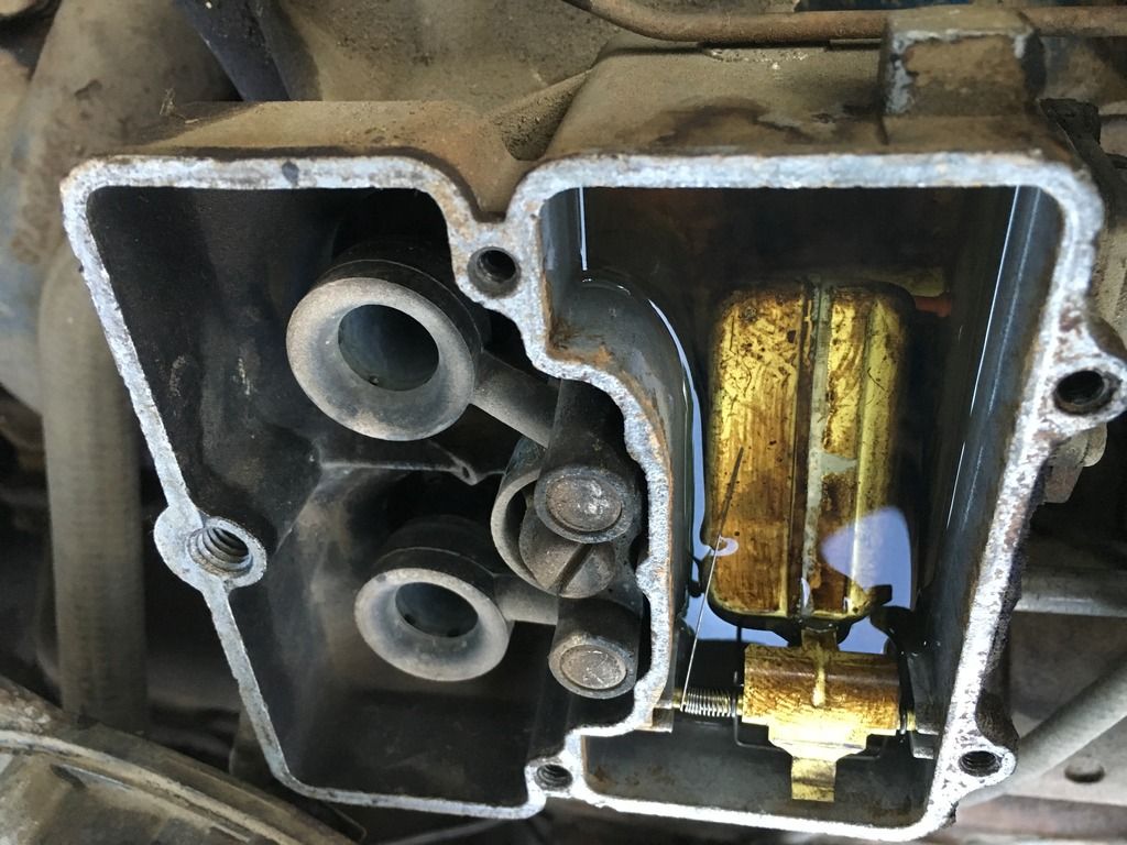

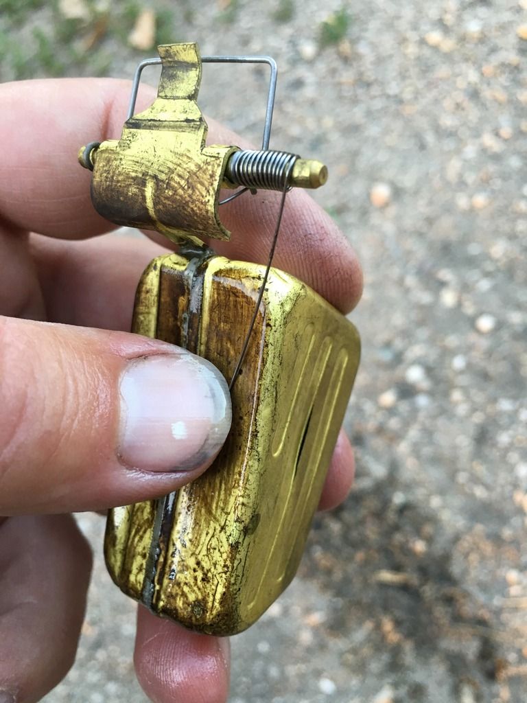

I had the car running and it died, the carb pumped fuel right out the top of the carburator.
I assumed the float had sank. It did.
And once I pulled out the float, I saw the crack.
I stopped today and picked up a new nitrophyl float and will install it when I get home. And I'll break out the test light and figure out why the passenger side brake/turn isn't working.

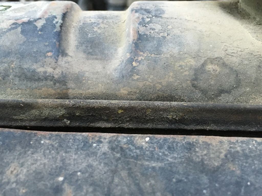

And the radiator is leaking at the seam.
