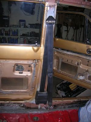

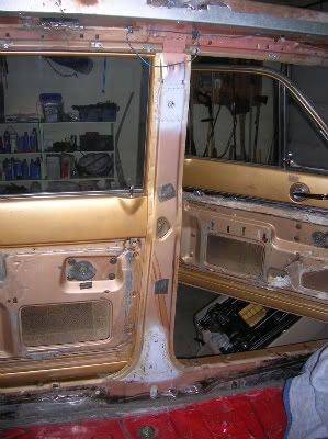

I retofit belts from about a 1980 ford of some kind many years ago into my 64 wagon. both the top anchor and the "box" mounted on the pillar. I welded a plate onto the pillar in both locations.

I put some in my 63 Ranchero. The donor was a 90 Probe. The retractor I bolted to a piece of angle iron bolted through the floor and rear cab wall. I slotted and rienforced the package tray.
