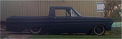

nater200 wrote:i never tried the maverick mounts. i did enlongate the holes to try to get the 250 mount to work with the stock frame mounts but the oil pan hit the sway bar. the easiest way i found was to just use the 170 motor mount on the 250. it gave me enough room to put a 5220 (electronic 5200) on a stovebolt adatper and 1 barrel carb plate with vacuum tube. i built a carb hat today i will be putting that on tomorrow. i already notched
the hood brace to accomidate a little 8 inch chrome filter. the hood is pretty rusty anyway
hey nater how much of a drop is on the ranchero? it looks dope! do you have problems getting the rear wheels off. i went 2 " on my wagon and thats as its a bit of work getting my wheels off.

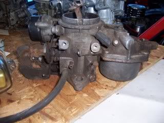

Been a while since I talked about this car :oops: . It has a Carter RBS on it now. Is this a good carb? Would I be better off swaping out to a holley 1940? I also have another carb I need to figure out what it is I can try as well. I think I'll have plenty of clearence now that I have a stock low-pro air cleaner and have several carbs to try out. Will keep you guys posted as I get stuff squared away. Thx for all the help!!!

The RBS is a later carb and probably the shortest available with the tea-pot fuel bowl setup. RBS also typically flows higher CFM . Shortest available air cleaner located was Maverick six air cleaner.
