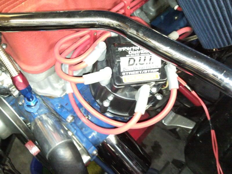

Just finished up my D.U.I install. This is how I did it, I ran a #12 wire from my battery with a fuse through a relay and trigger the relay with the old ignition wire. I took the car for a test drive and what a difference, I wish I would of done this along time ago. The car starts better than it ever has, runs stronger, idles better. If you have been thinking of doing this upgrade, it's well worth it. All I need now is an EFI kit. (hint, hint. Mike) LOL.......................
Bill
Here are a couple of pictures I took with my cell phone.
