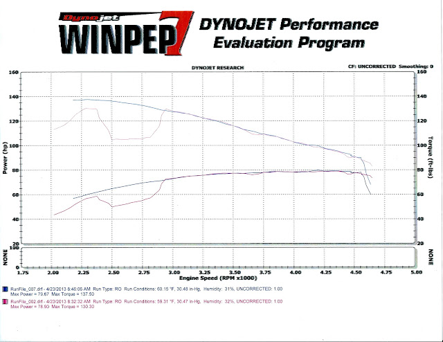

I grenaded the camshaft on this engine about ten years ago, rebuilt it shortly thereafter, and finally got the rest of the car reassembled late last summer. The new build has a bit over 1000 miles on it now, runs and feels good, no driveability problems other than a fairly lopey idle.
200ci .030 over, Comp 260H cam, small-chamber 170ci head, Winona bronze valve guides and stellite seats with standard 3-angle, oversize valves (80's vintage spec, need to look up the dimensions, it's been a long time ago), light port+polish, Clifford dual-coil valve springs and tubular pushrods, Mallory Unilite distributor and Promaster coil, 13deg initial + 38deg total advance, Clifford long equal-length headers w/port divider, 1.75" true dual exhaust, Offy 3x1 intake w/Pony Carbs modified Autolite 1100 (spec'd by John Enyeart specifically for this application). Standard trans.
Feels a bit softer than the last time I built it, which was with a 272H Clifford cam and Rhoads lifters, but drives out nicely.
I was absolutely shocked to see the dyno numbers (it's a reliable dyno, reports reproducible numbers on other cars). I thought I'd be anywhere in the 110-130 range, but instead...
Pink is first run, blue is after some tweaks. Dyno operator reported that jetting looked good, engine seemed to run strong, but to my eye something's clearly off. To save your eyes, that's 79.87 hp, 137.5 tq
The dyno operator delayed the opening of the secondaries a bit to smooth out the A/F ratios, again blue is second run...
It's a daily driver, so I'm certainly not after maximum performance, but I sure as heck expected better than this.
Guess it's back to fundamentals, check compression, etc., etc., but hard to imagine how something could be that far out of whack on a fresh engine without introducing driveability issues.

Very nice looking engine :thumbup: What compression did you end up with? Also what timing chain set did you use, was cam set straight up or advanced?

Yeah, that's the AFR in the second, along with the hp. The forum limits to 600px high images- I'll link to bigger stuff if it's helpful.

Post #8 by CobraSix » Fri Apr 26, 2013 1:28 pm
I loved my Comp Cam 260H.
While I never dyno'd my tripower, by the seat of the pants it had similar power as the OZ250 I ran with a 390 Holley and it dyno'd at 147 at the wheels. The Offy had more top end though and pulled like a mofo after 4000.
So, you numbers do seem really low and the AFR drop is the likely culprit. Figure +-20HP based on the dyno itself. Sure, it may be repeatable, but is there is an offset, it'll just show up each time.
Have you verified the outer carbs are actually coming and providing fuel (I know, obvious, but still)
Odd part is that on the first run, your AFR jumps up to 16 above 4k. I wonder the condition of the fuel pump, filter, and floats in the carb.

Post #9 by wsa111 » Fri Apr 26, 2013 4:53 pm
Very clean engine compartment. Craftsmanship excellent.
However, zero deck the block, get rid of the 170 head its strangling the engine.
Need a head with a large log & modfy from there. Get the head cc's between 50-52 & run a victor headgasket, its .006" thinner than the felpro.
If you stick with the tripower disable the power enrichment system & just richen the main jets on the end carbs only.
Eliminate the idle circuits on the end carbs.
As a matter of safety you should use invertered flare fuel line fittings instead of compression fittings or go the AN route.
The 260 comp cam is weak, very slow rate of lift. Any camshaft that requires only 50# of valve spring seat pressure is not giving you the best performance. Yes its a lot better than stock, but there is room for improvement.
Get a set of at least 1.6 or better 1.65 rocker arms to get more lift, rate of lift & more duration @.050" lift. The advertised duration however remains the same.
The best power is an A/F ratio 12.8-13.1 WOT. Cruise should be 14.2-14.7 for best ecomomy.
The 36-38 degree total advance is fine, but you need to shorten the centrifigul advance so you can at least run 18 degrees initial. Won't help your dyno numbers at the top end, but will definately enhance your low end performance.
Doing the above recommendations will get you close to 140-150 HP at the rear wheels.
Cobra Six has a great idea in making sure your fuel pump & lines are up to the job.
At least for the present get your A/f ratio's in line & do a little distributor work.
As i said your workmanship is above the norm, just do what you can afford. Good luck.

I'd add to FSD and wsa111.
In one Hot Rod article, Ak Miller and Jay Storer said any closed chamber 52 cc 170 head with the small chamber is up 30% on the stock (105 cfm intake) flow rate,
http://www.invectivus.com/hrm_mustang3/ ... 20copy.jpg
bringing the CFM flow 15 cfm above the ~120 cfm intake flow a big log post 1975 big valve engine makes. When you then add the big 1.75" valves to it, the small chamber 170 head then flows well over the 42 mm port 2V 250 heads intake flow rate, and more than any stock 75- 83 ~120 cfm flow rate head by a country mile. It's all about the quench and squeeze of air flow around the valve, and the ability to then get a better combustion chamber shape. Just getting the air flow right means you can then get more hp with the other standard head plane and porting modifications...the extra size of the later log head doesn't help fix up the triple carb flow rates, but opening up the carb holes and running fixed, simultaneous opening carbs helps control the rampant air fuel ratio swings. And swing it does, like a drunk mans wife pouring the hooch down the sink.. first lean, then rich, then lean again. Kevin showed us that a well set up combo on a calibrated dyno should get 140 rear wheel hp, even if the air fuel ratios are not ideal. The Offy and Edelbrock trip power intake isn't consistant fie air fuel because the porting is so varied, and you have to do dyno time to find out the sweet spots for ignition and air fuel. wsa111, Kevinl1058 and Falcon SedanDelivery know what advance curves work on a modified Ford six, and its heaps of inital advance and then a flattened delivery past 2600 rpm. Very important to dial in just the right amount or you'll be loosing power on the dyno andplug hole
It was the same with Kevins 206 with triple ICTs Weber Aftermarket 29mm ( a humble 138CFM @ 1.5" 34-ICH Replacement for old Land Rovers). The wild swings in air fuel are factor of the poor porting, a feature of the large diameter log, see his posts. Kevinl1058, viewtopic.php?t=64712
FSD decked his block and head over 100 thou each, and that makes a 250/170 head an ace in the hole. Invectivus can read the finer detail, and provided this as evidence.
See the invectivus supplied details in http://www.invectivus.com/hrm_mustang3/Cover.jpg
any 170 head is with the trip power is the bomb, but they show the large log 170 head.

Is the log as large a an 80 log???
With the small chamber & a lot of quench you probably need only 34 to 36 total advance.

Thanks for the advice- I'll start with the fuel pump, float level, maybe try a valve adjust before I pull the front cover for a cam degree. I'm surprised that it seems to sound, run and drive so well, considering how far amiss something clearly is.
I first built this engine pre-innerwebs back in the late '80s, when info was much harder to come by. Old Ak Miller articles were pretty much all I had to go on.
Here's the same engine in the same car last time around, some time in the late '80s-early '90s (heck, same fuel pump too):

datac wrote:I'm surprised that it seems to sound, run and drive so well, considering how far amiss something clearly is.
Yep...been there done that. Many years ago I built a 250 in a different Maverick...it sounded awesome and drove nicely...but it ran the same et's as the bone stock motor. I didn't degree the cam :nono: and I found out later it was way retarded. Once that was straightend out it ran REALLY good. Not saying this is your problem for sure, but this kind of stuff can happen. Good luck with your build and keep us informed! :)

Post #22 by xctasy » Mon Apr 29, 2013 8:02 am
:hmmm: Need some feedback.
I've discussed this before, but its very pertinent to anyone with an Automatic car
Is your T code a C4 auto, or 3 or 4 speed manual.
If its automatic, its certainly not unreasonable to loose 63% to the back wheels, so 78 hp at 4300 rpm could be up to 127 flywheel hp at 4300 rpm. Its common to loose that much with a converter, and its quite difficult to get good baseline figures with automatics, especially I6 autos, where the interplay between the dyno counterweight and the torque converter flash and stall readings can seriously skew the rear wheel hp figures.
See viewtopic.php?f=1&t=69807
I've seen a lot of dyno reports in my 43 years, and I haven't been able to see if your car is C4 equiped of not. If it is, a 1.63 rear wheel hp to flywheel hp figure is typical. On cars with Top Loaders, T5's, SROD's and Dagenhams et al, 1.264 is typical from the historical accounts. Apples must match apples, fluid drive auto's mess up the dyno results more often than you'd expect. It's also nothing for a chassis dyno to be out 15% even if calibrated. That's 40 rear wheel hp on a car making 400 hp. On a 145 hp flywheel hp engine in a front wheel 1435 cc Mini, going 50 miles across town to another chassis dyno, Dave Vizard lost 20 wheel hp, and got only 92 hp at the front wheels.
Help us fill in the transmission gaps. You might be lookin for a black cat, in a black room, that isn't even there!

3.03 toploader 3-sp at the moment (early small-pattern block with Econoline bellhousing), T-5 in the offing.

Thanks for that. I'd try some 0 to 60 mph times and use the cheapest of the following methods. You have dyno figures, you can calibrate the dyno.
I'd bet money the dyno is out of calibration.

Fuel pressure and float level checked out fine, got to thinking back to last Summer when I first fired this engine. Had a problem chasing down a noisy lifter, ended up replacing them with no improvement, after adjusting umpteen times trying to quiet it I recall I ended up cranking them down nearly 3/4 turn instead of the usual 1/2 turn which helped somewhat. Forgot all about that, thinking I'd sort it out later.
Readjusted the valves last night to 1/4 turn, definitely a bit noisier but the butt-o-meter detects a significant improvement. I'd effectively carved a big chunk out of my valve lift, nice. Still not certain what the source of my lifter noise is, which does bother me a bit.

datac wrote:Thanks for the advice- I'll start with the fuel pump, float level, maybe try a valve adjust before I pull the front cover for a cam degree. I'm surprised that it seems to sound, run and drive so well, considering how far amiss something clearly is.
There are four sizes of Autolite 1100/1101 carb, you need to measure the venturis.
Autolite 1100/1101 Sizes and Applications and CFM at 3"Hg.
1.00 Venturi(120 CFM): 144 ThriftPower Six (84.9 cfm at 1.5"Hg)
1.10 Venturi(150 CFM): 170 ThriftPower Six (106.0 cfm at 1.5"Hg)
1.20 Venturi(185 CFM): 200, 250 Six (130.8 cfm at 1.5"Hg)
1.29 Venturi (210 cfm)"223,262,240,250, 1963-1969 (148.5 cfm at 1.5"Hg)
If you have the smaller ones, that's where your hp has gone. The right size for power is the 1.29" venturi, and the size of te carb hole has to be as big as you can make it. Running them all on at the same time is best for power, as the air fuel ratio can swing around a lot. Your peak 1.5"Hg cfm as you would meadsure a 4-bbl with good 1100's and 1101's is just over 445 cfm, which is 21 cfm less than the best triple 1.352" venturi 1940 Holley and two 34 Weber IC versions with the 29 mm 1.14 " venturis. With the smallest 1100's, you'd be lucky to get 255 cfm.
If you can report back to us the venturi sizes, and you'll have the peak cfm figures at 255, 318, 392, or 445 cfm. Your peak power will be way low if you only got some 1" venturis.
There are bigger 1940's around with 212 CFM or 149.9 cfm at 1.5"Hg, or about 450 cfm total. The smaller 1940 has a much smaller venturi, and much less power.
The article doesn't really use the word "any", so I've always interpreted it in relative terms- the small log 170 head flows about 30% better than the small log 200 head, and the large log 170 head flows about 30% better than the large log 200 head.
