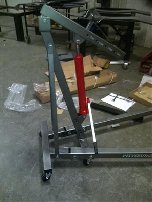

Post #9 by CoupeBoy » Tue Dec 15, 2015 12:01 pm
I'll be the guy to say it..
I bought the Harbor Freight 1ton unit when it was on sale for $99.
It folds up nicely.
Assembly pictures can be found in my photobucket album.
HF Engine Hoist -- PhotoBucket.com
It has lifted and moved everything I needed to move so far, 170, 200, 250, 300..
I loaned it out to a friend who moved a 235 and removed a 350.
It has NOT been used to put any motors back in yet.
At full extension, it is only rated for 500lbs.
