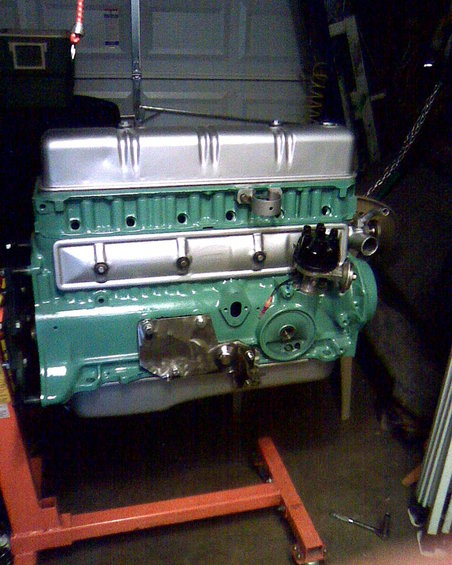

Here's pics on how to swap a 215 to a 223 in a '53 Mainline
Post #1 by texas_rat_trap » Wed Oct 01, 2008 10:11 am

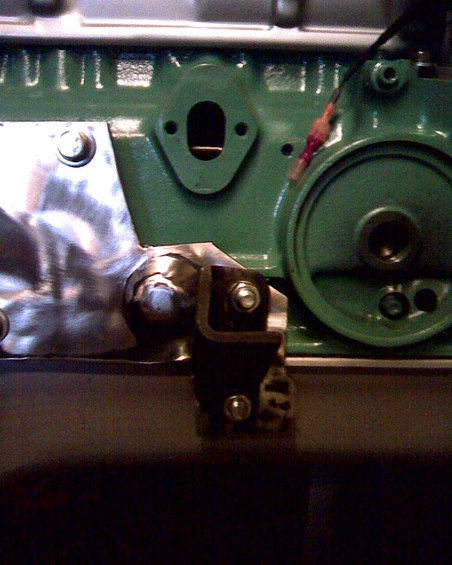

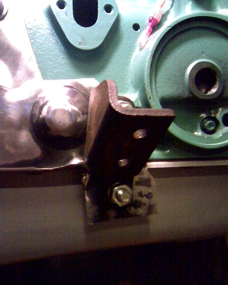

Make adapter plates out of 1/4" thick steel plate that bolt to 223 original mounting holes, use original 215 engine mount brackets bolted to adapter plate & flip original 215 '53 Mainline mounts around on cross member....No welding or cutting cross members, all bolt in. :D the adapter plates raise the engine about 3/4 to 1". These mounts are not cleaned up yet and are raw for test fit, and they work perfectly no oil pan or steering linkage clearance issues.

Hey, is your fuel pump going to hit that new bracket you made when you try to install the fuel pump ?

Daves55Courier wrote:Hey, is your fuel pump going to hit that new bracket you made when you try to install the fuel pump ?
No, it won't hit left enough room to use mechanical pump, but will probably use an electric fuel pump.
