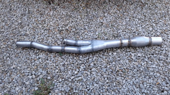

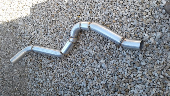

I too built my own. Long tube headers into a y-pipe built off of a flowmaster scavenger y-collector. 2.5" downpipe into a single 3" magnaflow cat, into a single borla xr1 muffler and out a single 3" tailpipe.
Loud, yet refined sound until about 3000rpm where it starts screaming like a wild banshee
Y-pipe
Tailpipe
Full mockup
1985 Bronco. 300-6, NP435, 4.56 gears, Detroit locker and tru-trac, 4" lift, and 37" swamper tires. 300 has a 4bbl and headers.
