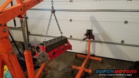

As some of you know, my engine got ruined. It somehow experienced detonation that hammered down all the rings, ruined the valve guides, and trashed all the bearings.
Last month, I broke it down, disassembled it, and did another full rebuild. Fortunately, it was a lot less involved than the first go-around since it was just now a "basic rebuild". It's now bored 40 over (instead of 30) and has new pistons, rings, bearings, valve guides, etc. Had a new valve job done and had the crank polished.
