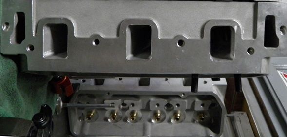

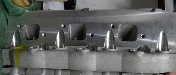

Post #151 by 300FOREVER » Fri Sep 16, 2016 9:44 pm
Drivers side intake....
guhfluh

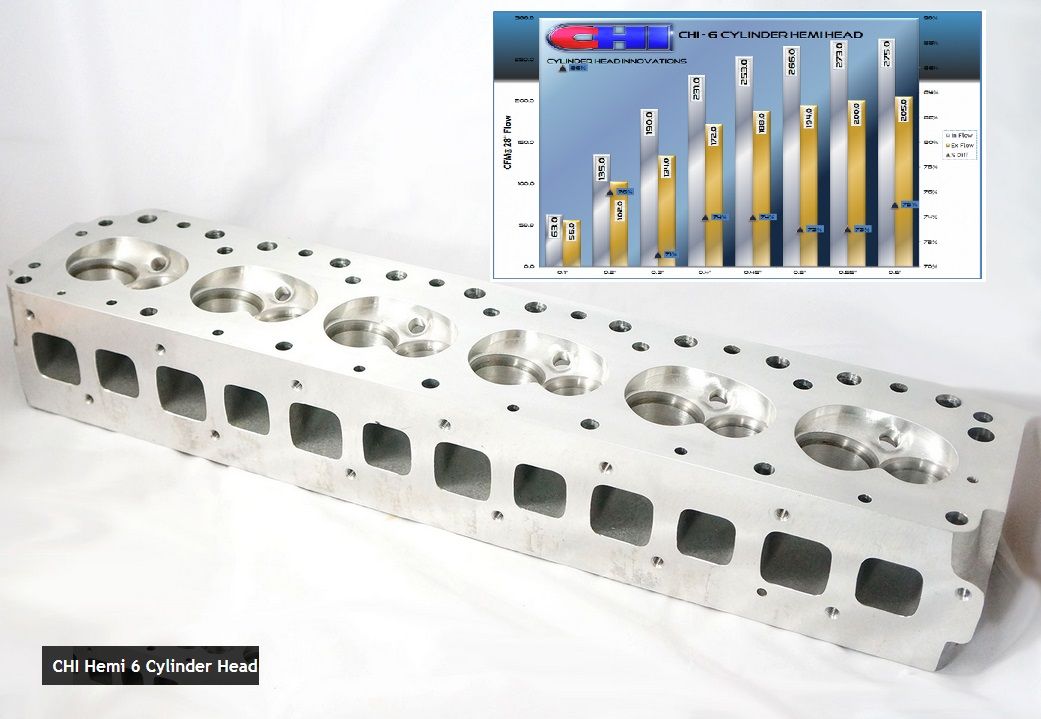

Gary Isbell ran low 11 second quarter mile times in his Modified Production Maverick back in the mid-1970's with a 300 engine in it. Using modern porting and cylinder head techniques we have now in the 21st century, a stock production cylinder head still offers more than enough potential for what people are seeking to build, and a crossflow or even an aluminum head for that matter is going to have so much untapped potential because maybe only 2 or 3 people would build something that can go fast anyway in a doorslammer.
Also, don't fool yourself on how large the inline parts demand really is, Edelbrock and other companies only tool up and makes products for markets that have large demand for them. Even though those markets may not appear large to an inline guy, they are really huge when you look at the market on a worldwide scale, while the inline market is not except for the sport compact inlines which is much larger that the ones here. Even back in the 1960's and 70's when a really large number of inlines were built and raced, even though big companies did make certain products for them back then, many other basic products still had to be made or adapted from V8 type parts. So in a nutshell, if the demand was truly there, someone would make what it is that is being sought after. And the simple fact that those items are not being made tells the reason why.

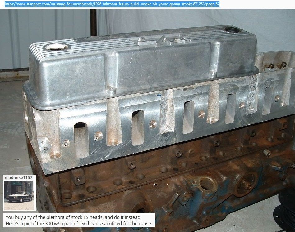

That LS hybrid head has been around for a long time, but all we have ever seen is pics of it, and nothing about it actually ever running under its own power. The fact that no video of it running says a lot in itself, seeing its been around for many years now. Either it was a dud or not much to brag about even though it is pretty exotic looking. I have several brand new LS heads myself I could cut up and create a pattern to cast a good modern 300 race head from, but there so far hasn't been a waiting list for people wanting them or needing them. There are quite a few 8 and 9 second quarter mile Chevy inline doorslammers, lets see some Fords start pushing that envelope and maybe the demand for better things will start to interest those that can make that happen. Just thoughts.....

If I buy an aftermarket head I don't want anything dealing with a ls. I either want something designed from the ground up for the 300. Or if it has to be based off something then I want it based off a modified ( with correct valve order for 300 cam ) 351C aftermarket head .
But I wouldn't mind an aftermarket U-flow head either. Make the ports slightly wider and also taller and the flow will be there. Add more beef to the port and bowl walls so they can be ported more too.

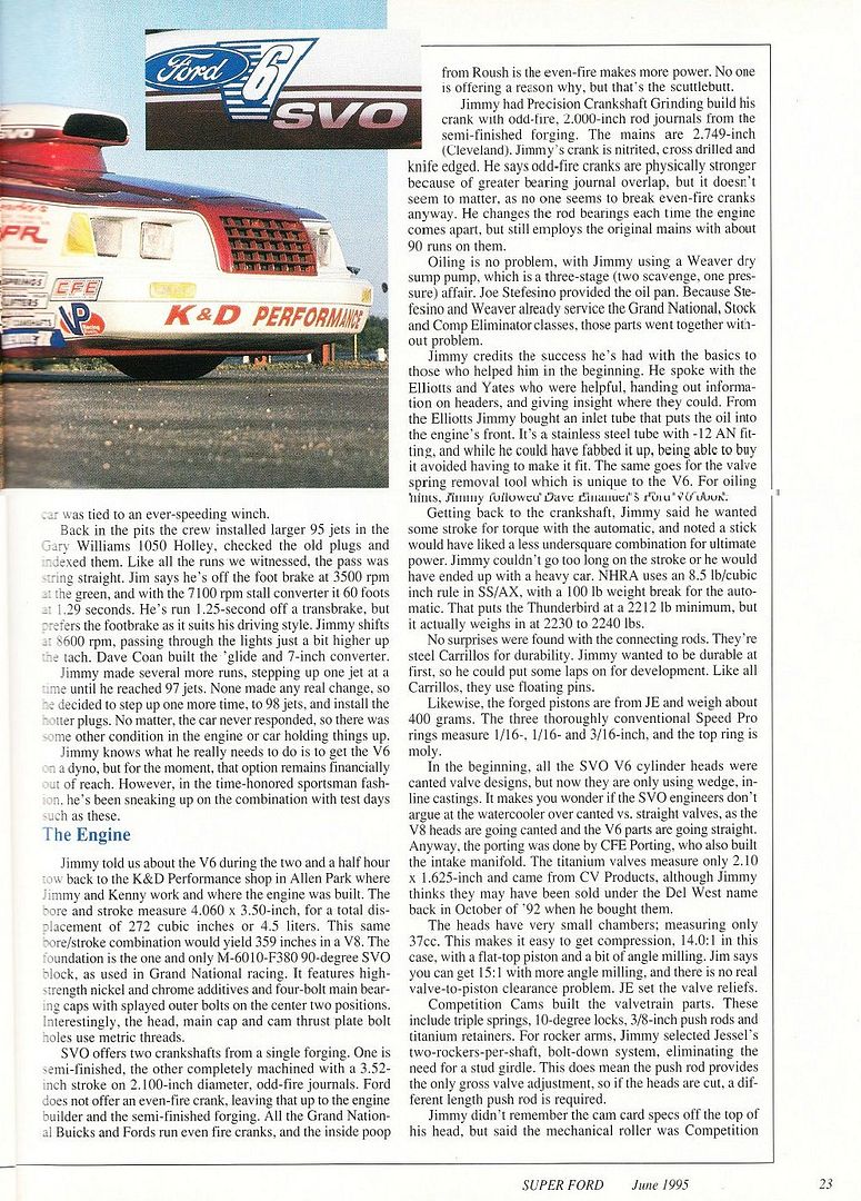

The M-6010-F380 SVO block was often 272 cubic inches. With one 1050 4bbl and four square 98 jets with the early odd fire crank, there was enough hp for 9.47 seconds at 147 mph with 1.25 sec 60 feet and 2235 pounds at the line. Revs to 8800 rpm, with power at 7700 rpm.
As development continued, it did less time with less mph.

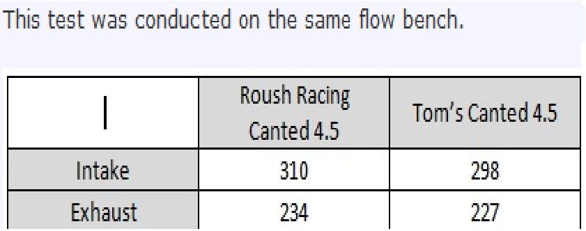

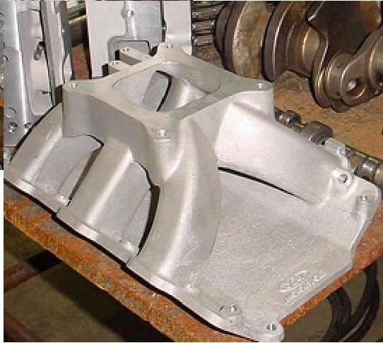

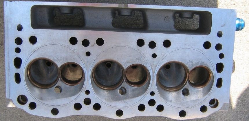

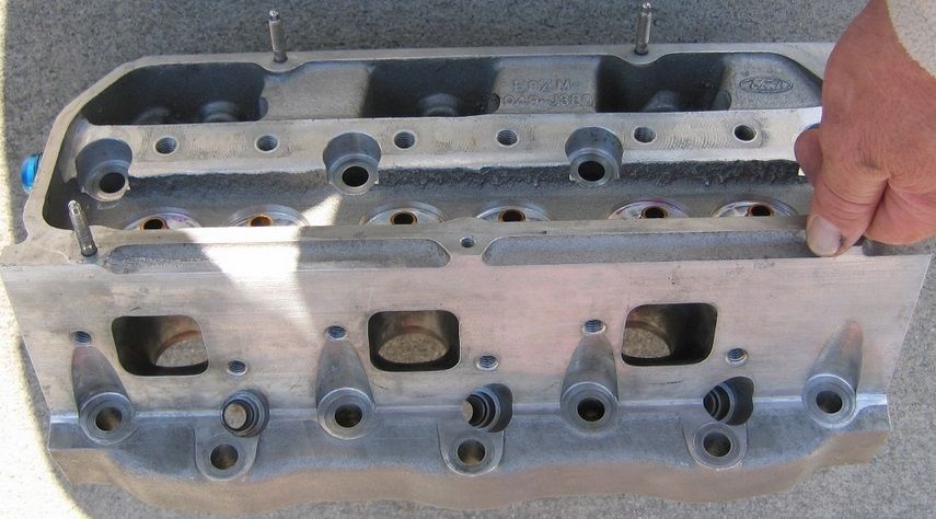

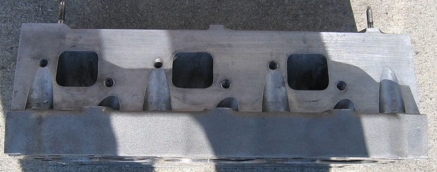

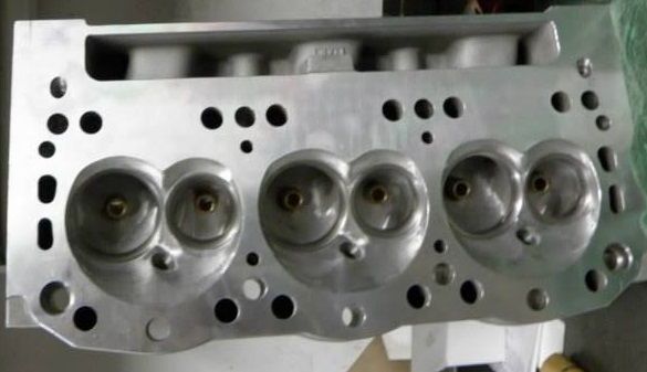

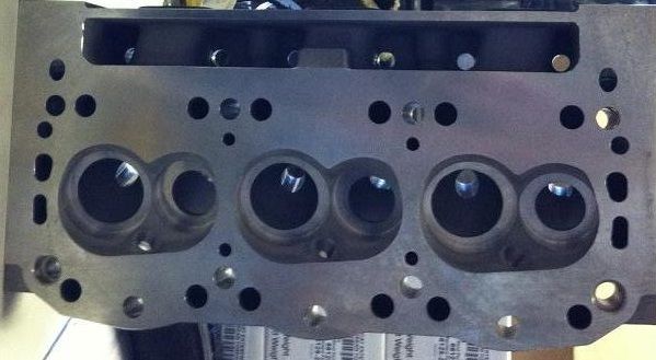

As noted, SVO downgraded from the earlier Canted valve Cleveland style heads made by Cosworth Engineering under part number Canted E8 ZM 6049 E380 to a totally new non canted valve Brodix cast head under part number E9 ZM 6049 J380 head in 1989

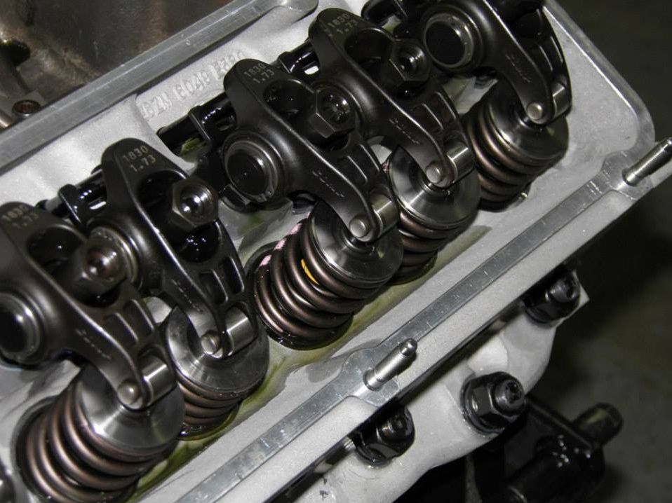

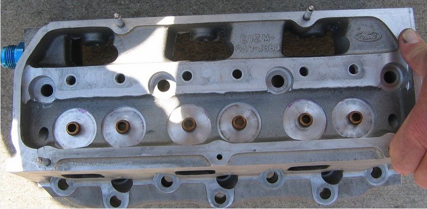

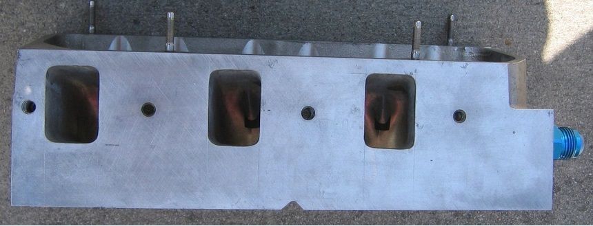

Early Cosworth heads...E8 ZM 6049 E380. Ported NOS canted valve heads (298 in, 227 ex flow @ 600. 2.125/1.710 valves)
After chamber work
Before chamber work....as cast

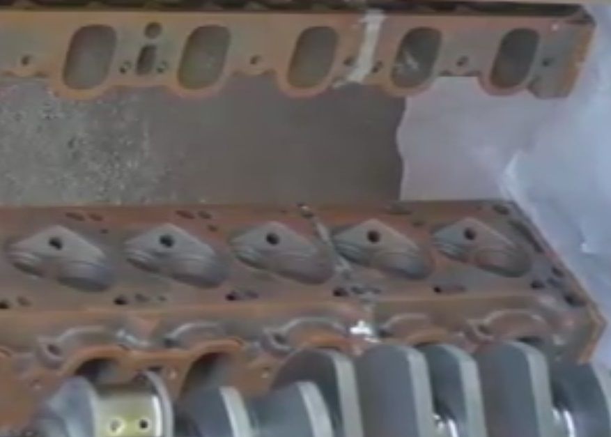

The EFI intake runners could be anything...the M-6010-F380 SVO block and its head used a truncated NASCAR Winton Cup Cleveland Windsor intake like this....

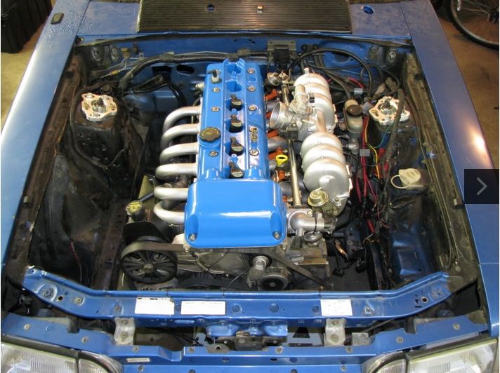

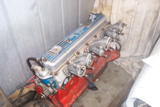

When tilted 45 degrees back to the normal postion, you get this
The cross flow machine above packges a funnel ram intake under the hood, really well!
The DOHC blocked I6 engines from Chevrolets GM 4200,
and Ford Australias Falcon are punny little 4.045 or 4.08" bore center engines, lacking in capacity, block strength and with too much port veloicty from very small ports.
There is little evidence of increased BMEP with DOHC in line six cylinder engines, For dAustralia found that in 1992 when Tickford did the DOHC Jag head to Falcon 250 swap. For every horspower, you have to be turning more rpm for every cube. The gains in DOHC are specfic torque, where a good DOHC engine might make 1.65 lb-ft per cubic inch, where as a 2V per cylinder engine might only make 1.4 lb-ft per cubic inch. Peak power, a two valve per cylinder engine cna match a Cammer 4 valve, its not as clean burning, or as detonation resistant, but every NASCAR engine outdoes a F1 engine on the basis of hp per cube for every 1000 rpm. I don't care if some engineer starts talking BMEP, that sort of stuff doesn't make peak power gains at 7000 rpm. That's hy Ford turbo'd 4 liter sixes and Supercharged Coyote V8's, because they already have better otoeque on the road, but were missing peak hp compared to a really good 2 valve per cylinder EFI engine.

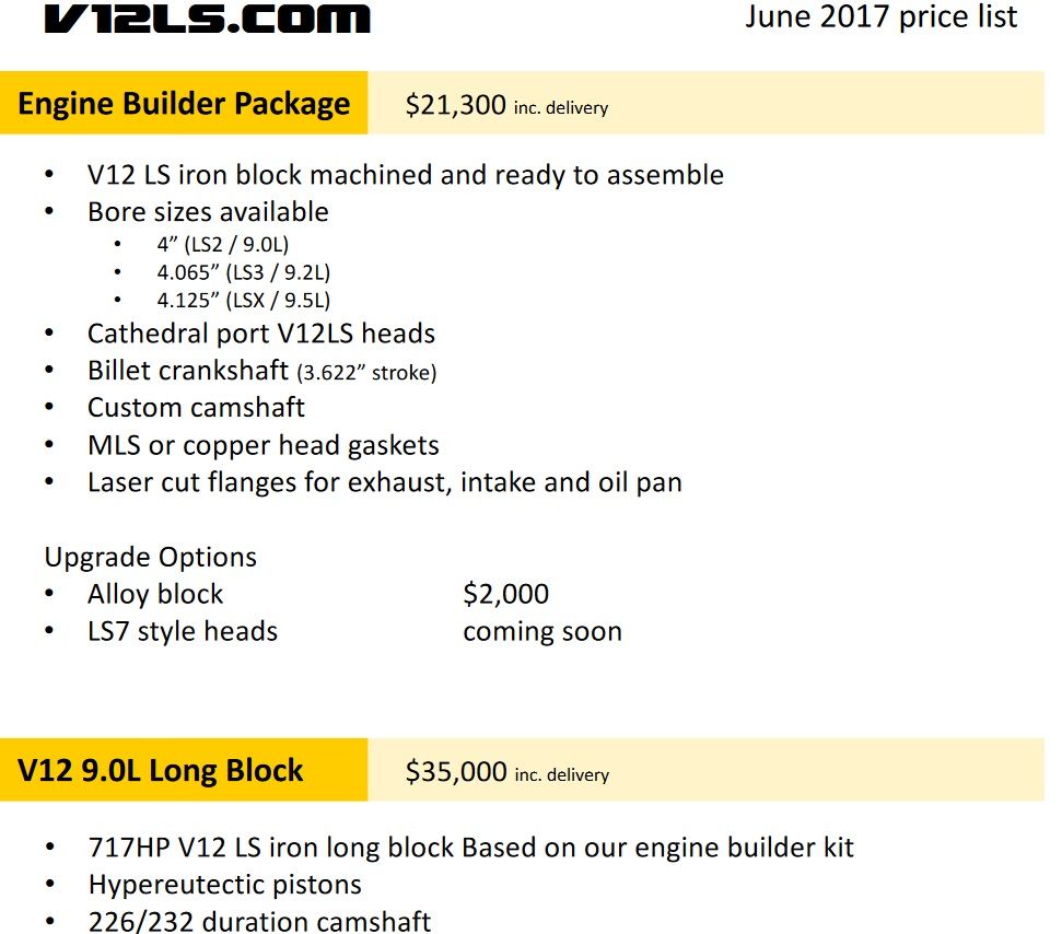

Wonder if these LS V12 guys are willing to sell some heads.
http://v12ls.com/
88F15088
Posts: 163
Joined: Mon Sep 11, 2017 12:24 pm
Re: Big Six aluminum head update 9-14
Post #178 by 88F15088 » Sun Oct 22, 2017 12:41 pm
Econoline64 wrote:Wonder if these LS V12 guys are willing to sell some heads.
This is a great point. Their head would pretty much bolt right up wouldn't it?
Fordman75
Posts: 993
Joined: Fri Nov 08, 2002 2:43 am
Location: Southern, Minnesota
Post #179 by Fordman75 » Sun Oct 22, 2017 1:40 pm
The problem is it's still a ls head. Find me a guy that builds V12 Clevelands or a V12 from 4.5L SVO engines and you'd have something! :D :thumbup:
Ted
54 Ford F100/F150 4x4
300, NP435 4spd, NP205 transfercase
Posts: 6744
Post #180 by xctasy » Sun Oct 22, 2017 8:46 pm

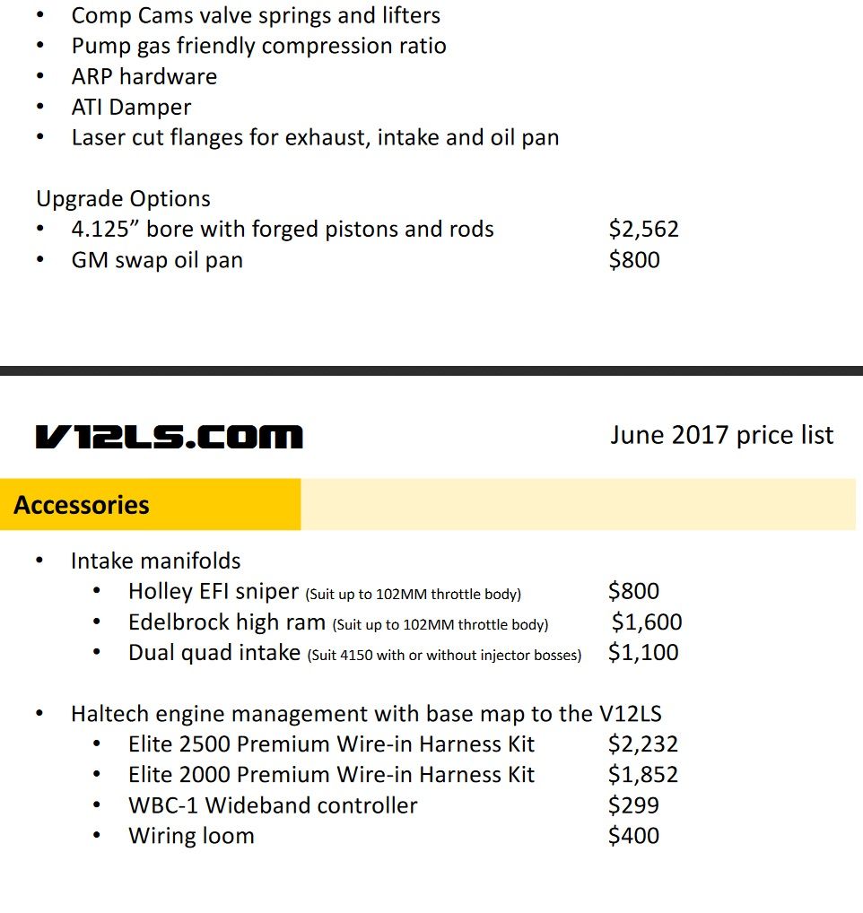

A welded together set of unported 241 heads
Home builder package from 21 grand, pre-assembed 35 grand, full engine 46 grand.
http://www.enginelabs.com/news/video-au ... -s-shores/
http://v12ls.com/wp-content/uploads/201 ... e-list.pdf
Straight bolt up....only after you cut it, and adjust the bore spacings back to 4.48", not 4.40".
Lots of additional work on an already expensive engines head...

Post #181 by 88F15088 » Sun Oct 22, 2017 10:10 pm
I sent them an email just to get an idea on pricing, or if they are even interested in selling only one cylinder head. I will report back with my findings.
88F15088
Posts: 163
Post #182 by 88F15088 » Sun Oct 22, 2017 10:56 pm
What's the bore size? I have Googled a bit and found anything from 3.8" to 4"
It's 4", correct?
Posts: 6744
Post #183 by xctasy » Mon Oct 23, 2017 7:08 am
LS2, LS3, LSX
4.00, 4.065, 4.125"
And it still has to be cut, sliced and diced, then rewelded or expoxied back together.
arse_sidewards
Posts: 822
Joined: Mon Jan 21, 2013 7:18 am
Post #184 by arse_sidewards » Mon Oct 23, 2017 8:23 am
xctasy wrote:LS2, LS3, LSX
The bore spacing on the 300 is 4.480" and the LS is 4.400".
If you just plopped it on and split the difference the chambers would be off by
The chambers would be off by 0.040" (3 an 4), 0.120 (2 and 5) and 0.200" (1 and 6).
Why can't we build the chambers back up on one side and cut them on the other?
I know welding cast AL sucks but putting some 1/8" wide stringers on a high quality head casting is probably the easiest cast aluminum welding job ever. It would be a heck of a lot less work than any cutting and brazing job. Head bolts could be adjusted into position in a variety of ways.

I talked to those LS V12 guys last year at SEMA. Initially they were interested in making a head for my '64 Econoline dragtruck project, but after a few emails they dropped off the face of the earth!
As of last year, their heads were just welded up LS stockers.

Does10s wrote:I talked to those LS V12 guys last year at SEMA. Initially they were interested in making a head for my '64 Econoline dragtruck project, but after a few emails they dropped off the face of the earth!
Will
Yep, just like everyone elses.
But just get three junked A3 Yates or iron Cleveland heads..they are everywhere, and better.
As the man says "its easy to over think this....."
