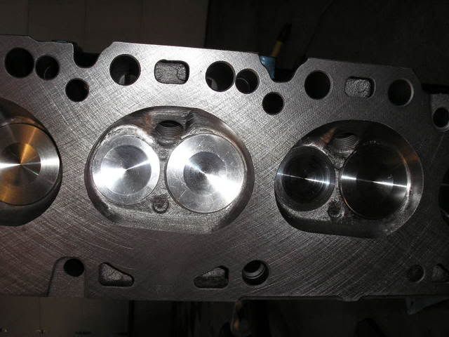

ported 300 head
Post #1 by nitrousnick » Sat Jan 24, 2009 7:00 pm
done at Extreme Speed

Post #2 by StrangeRanger » Sat Jan 24, 2009 7:05 pm
Have you got a pix of the bowls and valve guide bosses before the valves were installed? That's where the most interesting stuff is hiding.

Post #8 by nitrousnick » Fri Jan 01, 2010 7:48 pm
I had the head done by cliffords in the late 90s.I told brian at extreme speed what I paid cliffords to do it back then and he told me I got screwed.He had seen work like that before and is sick of these places ripping people off.
Brian at extreme speed ported it,fixed all the valve guides,new valves.The only reason i took it to him was because the valve guides were wiped out of it.Brian told me i had a geometry problem and even came over to my house with one of his friends thats a expert in ford engines.I ended up needing longer pushrods.From all the work he did the car went from running with 100 shot of nitrous 11.80@110 to 11.60@ 116 and on engine alone went from 13.6@96 to 13.2@102. I thought that was great,he did a great job,what a huge improvment.It cost about 1g with all parts and labor.That was what cliffords charged me the first time.

Post #10 by eeyore » Mon Jan 18, 2010 9:32 pm
Hey Nick, what intake are you using? Did the intake need to be opened up to match? Bowls look great, I was a little surprised by the lack of any remaining boss in the exhaust port. Nice! :beer:

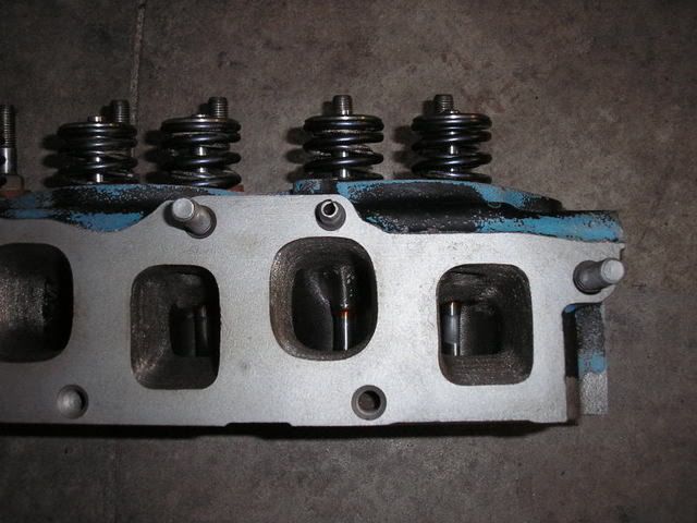

Post #12 by 82F100 » Thu Mar 18, 2010 4:10 pm
Nick, here's some pics of my head for comparison,This head was done several years ago and I have learned allot since then and the person who did the work this was his first inline 6 head.
