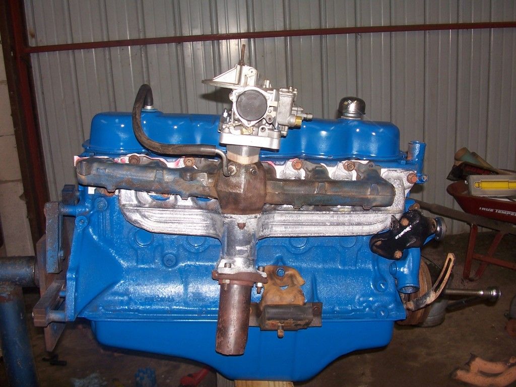

Earlier i posted a build i was working on and the rig is a ford f350 dually -real heavy about 8500 pounds without all the crap i lug around with me.
Well i got the build done, and it sits in the rig waiting for me to refit the rear axle before i start it and put it to work.
today i happened to meet my turbo builder for my dodges and my equipment.
he told me that he would build a turbo kit for free, just to try it out on a 300 inline. "always wanted to do it" he said. so i will accept his offer but
I want to know from fellas that have done this if a turbo'ed 300 will be a good mix with a heavy work truck.
i am using the 460 oil cooler system now and i have a 460 radiator in the rig, ; cooling is covered. we will use an intercooler air to air. from a mustang or something.
for free i am sure he meant that i buy the parts but he designs the system.
what are the opinions here on this

i know we will use Garrett turbo. the turbo needs to be as close to the exhaust ports as possible , the distance traveled by the exhaust will cool the gasses and the gas density will change so that the turbines will not spin up as well as the gasses cool.
Kent, the turbo guy has experience only with gassers in terms of modding, and he does mustangs mostly.
the newest thing, he says is to weld a v band clamp directly to the exhaust manifold and turbo housing using stainless rod or wire.
thusly eliminating the mounting flange, gaskets and bolts .
intercool the air, and i am running it through a FISH carb so we are breaking new ground here all the way through. No need to heat the intake manifold anymore, cooling the charge is more important
Nitrous becomes easy
I am encouraged to hear about the power possibilities.i would like to see 15 mpg and lots of torque.
the other thing that just occured to me is that we will eliminate the time lag for fuel/air to reach the outer cylinders. the turbo can maintain full pressure to all ports all of the time.
will this mean that we will have even combustion temps cylinder to cylinder and no fall out of fuel from the intake charge ???
Damn! i could use my fuel injection intake with a the fish on top! equal length runners!
Kent imagines about 13-16 pounds of boost, timing is a big guess.
could i use individual coils for each plug?
Im using MSD right now , that will hopefully prevent spark squelch.
I hope my head bolts are enough to hold pressure.
thanks again fellas!

what about this?:
turn the exhaust manifold upside down, to see if the outlet would clear the clifford intake or clear the F.I. intake. v clamp the turbo directly to that exhaust manifold.
use a cross over pipe, eliminates need for the intercooler; the propane will cool the air charge, and the air will heat the propane.
waste gated @ 9psi. thus no fire ring or studs hopefully.
ignition.
am i off the mark to get a knock sensor, and manually adjustable advance type firing system.? is there an aftermarket ignition system that incorporates knock sensor and automatic timing adjust?
i really dont know too much about this kinda thing.

Would you mind sharing the Jobber in Portland's name and contact information? There were a couple guys on here looking for the forged crankshafts..
Do you think your turbo guy would be willing to do a couple turbo setups? One with a stock manifold and one with a heavy duty one? I ask because there are going to be several on this forum that would buy a downpipe and mounting bracket for a stock manifold that would not have the heavy duty setup.
From one of the other threads (need help with 1976 industrial 300), I think this is the industrial manifold that you are looking for.
This thread also has quite a few pictures of the Industrial exhaust manifold
300 HD heavy duty exhaust manifold
From that thread, this is a nice peice of math for those that are interested..
AbandonedBronco wrote:The stock log exhaust is a single 2" outlet.
That's 3.14 square inches of exit room.
The EFI manifolds are dual 1.75" outlets.
That's 4.81 square inches.
The HD manifold is a single 2.5" outlet.
That's 4.90 square inches.
And if you scroll through it long enough, you eventually find a URL to a vender that claims to sell them.
Stevens Specialty Engine Parts
Where he has the nicely listed showing various exhaust manifolds..
1965-83 Truck
With heat riser, with female flange
1981-86 Truck
With heat riser, with male flange
1965-74 Truck
3 bolt flange, Hvy. Duty
Casting # D7TE-9430-FC
And the EFI manifolds
1987-96 Truck, Van
Front
Casting # E7TE-9430-GA, GB, GD
F5TE-9430-DA
1987-96 Truck, Van
Rear
Casting # E7TE-9431-HD,
F5TE-9431-DA
