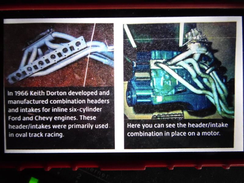

Keith Dorton intake/header combo
Bill in SC
Posts: 19
Joined: Sun Aug 03, 2014 11:31 pm
Post #1 by Bill in SC » Sun Feb 28, 2016 9:02 am
Anybody run one? I have an old friend here in town that used to make similar ones to race on dirt tracks... He said if I got the flanges, he would make me one...

This one was bouncing the web a while back, and is kinda-sorta what I was thinking:

Bill in SC wrote:Nice lookin stuff!
To be clear.. I was offering to mail you the 3/8" plasma cut 1pc flange for the price of shipping.
About that blue one, it sold on eBay a while back and one of the forum members bought it.
I snagged these pics from the auction.
He resold it because he was concerned that fuel would pool in the intake runners that drop down and then come back up for ports 2, 3, 4 and 5.
