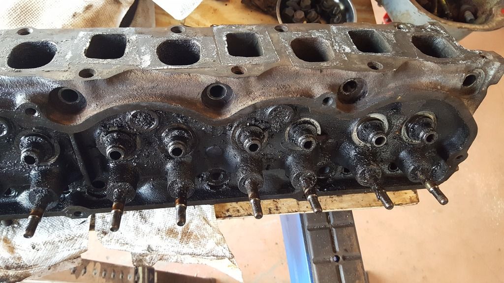

I did pull the water pump off and noticed inside the head it is a bit rusty. Appears to be a rusty film instead of established rust.
I am going to start pulling it apart today and will take pics every step of the way. Better decisions I think can be made once it is apart and see what it needs.

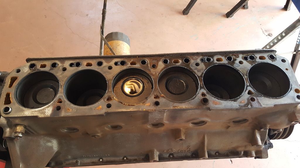

Do these look like the original pistons? They are low compression....

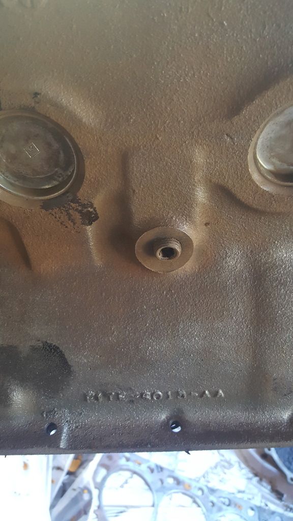

Can someone tell quickly what this Allen head bolt is for? I am ready to take this block to the machine shop this afternoon and have removed everything but this tight as *&^*&^* bolt. If it is not important will just leave it.... It is on the right side(passenger side) just above the numbers....
Thanks

The allen head plug on the passenger side just above the lettering is to drain the water jackets. It can stay in.
You should be able to see or feel the back side of it once you remove the freeze plugs.

Those are the stock 1981 pistons. The Silvolite 1170 is the replacement piston.
The round dish has about an 18cc volume and the pistons sit about .040" in the hole at TDC.
With a .039" thick head gasket and a slight overbore on the piston size the compression ratio should be around 8.5
