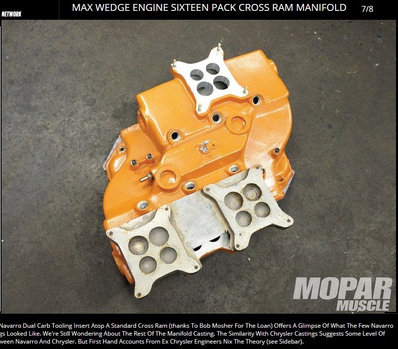

I cant sppon feed it to you, but the secrete is that duty cylce over lap hurts idle and wide open throttle performance. The muddy waters to this are other things entirely.
Port on port carburation isn't being done here, but the same basic principals apply. A port on port discussion is here
viewtopic.php?f=2&t=77685&p=608580#p608817
The principlas are two fold.
1. Only when overtly large, and independent runner, port on prt carb systems, does an engine respond to pulse tuning. Pulse tunning allows more fuel to get in with less air flow.
2. On all other Non port on port Examples, you have to avoid earlier production common USA I6 and V8 2 and 4-bbl thinking. Not that its bad at all, its just that it focuses on cost and undercarburation, and using cam design is a crutch as opposed to to sizing the the average carb venturi areas to the total the engine capacity for a given rev range. Mike Stacey from Chrylser Australia Party found that port on port worked best, but that 4-bbl long branch intakes like the Dutra 4-BBL also worked. So did a Repco Ford Falcon development engineer. Both realised that it was carb venturi to engine size relationship that made up for a lack of port on port intake design. A great deal of that information filtered into the early 4-bbl Big Six experimental intakes, showing a real understading of how to make a n I6 idel, and perform with very big carbs.
"Pulse tuning" for carbs only happens at about 11 to 18 feet per second of air flow, so you have to go really REALLY big to pulse tune. Forget all that CFM flow rate hocus pocus. Well, not exactly forget, but don't get het up on it. My advice is to Only focus on the ventrui area required to match the peak power rpm for the capacity of engine. This process is called Dimensional Analysis, and all great benchmarking engieers use it. They just don't tell you they benchmark.
Oversizing is okay if you work within known limits. Then engine will rev well above the peak power rpm band . 5500 rpm is a good figure to punt for. Twin 1.08's might work, but other bigger Autolites and Motorcrafts can and do work better, without hurting idle.
viewtopic.php?t=41010

This is exactly what the 8bbl aftermarket non Max Wedge intake below does. It puls tunes 6 cylinders by using 12 venturis. Its overkill, but it worked right to 10000 rpm and over 600 hp, and with valve lifts of 900 "thou".
https://www.hotrod.com/articles/mopp-10 ... ing_insert
And the Jim Headrick Cotton Perry from Georgia was a Sportsman-class, 310 cube 67 M/Elim Chevy II driver who did it all with its three huge 780 cfm 4-bbl DZ option CrossRam carbs.
The way it works is that if you isolate, you can then increase carburation without hurting idle. Ford did this with the bigger spread bore carbs on V8's to countact the cost of running multiple carbs. They then had a heap of other matters to contend with to control idle. Cam design was seen as the great soltuion.
IMHO, Shared intake pulses always hurt idle. To improve shared plenumb or siamesed port engines, you have to look at ideal sizes from historical non USA engines, becasue the USA I-6's and V8's are frequently undercarbed, and don't idle well because of intake restrictions or card size restrictions.
Generally, first in the minds of North Americans is to increase port velocity, which is what actually Causes idle quality degradation, and peak power loss. The smaller the ports, even if really nicley gasflowed, the more the idle suffers. Its big ports with big cams and insufficent carb area that causes a lot of idle and wide open throttle issues, which Detriot covered over with secondary barrel operation.
Going to a bigger carbs on non isolated runner systems can also work darn fine. Although absolulety none, nada, nil, nein in line six or V8 US production performance engine ever ran port on port induction (exception...some British build, US order 289 GT40's did)
Non port on port Examples:
