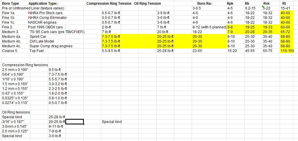

Elemental Analysis of oil is usually performed using Inductively Coupled Plasma (ICP) spectroscopy, and some of the moly could be from other parts, especially if someone has done the hydraulic lifters and used cam paste. Additive Manufacturing (AM) is a new way to make common grey iron work like a higher quality ring, and if its broken, then it'll show up even if its just one ring land thats got a top ring problem. If they used the reference ISO cleaness or particle count micron levels, (an example of the various reported micron levels includes those greater than 4, 6, 10, 14, 21, 38, 70 and 100 microns), they pick up oil change to oil change proof of wear. The used filter anaylsis is also an excellent indicator.
The whole part of getting Thinwall Henries to work in a modern performance world is ensuring the rings bed in by doing all the basic work to ensure your percentage shots work in your favour.
Form my readings, indications are that even back with the Ford Performance Big Six project, Bruce Sizemore was final plateau honing the bores of the Preparation H Maverick with 600 micro inch grit back in 1972, and that's where you should be headed too.
I'm adamant that you cannot safely re-hone a modern cylinder bore in a thinwall Ford, as the distortion exists in everything made that way. Piston slap is probable in those cases, irrespective of what type of piston you use. You can grab a Truck, Taxi or Police Cruiser engine, toss in a blister pack bearing, ring, bolt and new piston kit, and turbo it and win races, or go oval track, and do the same, but an engine like that gets watched and striped fairly regularly. WorkenToo Much will tell you how good a later hyper 1994 on 4.9 is.
If your going to use it as a dual or triple use truck engine, then you have to rebore it. You don't have to align hone, you don't have to do the crank mains, or re hash the crank bearings, that introduces other matters to contend with. You don't have to put it on a Humbolt vibrating table, and shake and rattle it for a couple of hours or days, but all of that can be done, and pays off if you do it right.
My opinion, is the same as the ProDrive and Tickford did when re animating the ancient 302 EFi Explorer Mountaineer engine for the 1999 to 2003 295 and 335 hp 5.0 and 5.6 stroker engines. They took a fast cast thinwall Cleveland foundary WCP casting, and just plateau honed it, and used HyperEutectic pistons, and to do that they focused totally on getting a good bore finish, using some ages old technique with some new focus points.
You need to use common sense and do the following:
1.Use a good bore gauge.
2. Have the block carefully to honed straight.
3. Keep the bore geometry within .0005˝ or less of being round and straight, ideally within .0002˝ to .0003˝ of specifications.
4. The modern focus is to brush the cylinders after honing with a good quality soft brush tool to clean away the torn and folded metal debris.
5. To get there, often three kinds of modern kit are used, some final stages use a Bruce Sizemeore style 600 grit hone. It all varies, because the measure of succes is actually
These six following quotients:

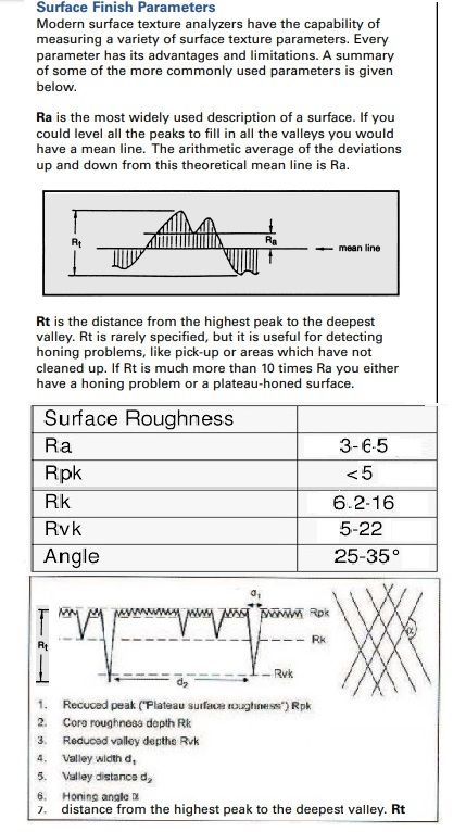

The units above, in my opinion, are not important since the term micron and the place holder in(,) are not used as per the European book I got the info from. The angle is the horizontal angle, not the vertical included angle, so some conventions vary.
And Ra, not an Egytian deity, but a dreaded Roughness Average which is bandied about, isn't one of them, but its used as a final reference.
The type of honing media and finishing procedure you should use depends on the application, and I've got the figures below.
The basic process is in https://www.aa1car.com/library/plateau_finish.htm
Lyle Haley of Peterson Machine Tool says #280 grit stones are a good choice for most applications, but are a little on the coarse side and by themselves won't give you a plateau finish. He uses a #400 grit stone for at least .0004˝ to .0005˝ of conventional subtractive stock removal, but not much more than that or you will be down to base metal. He then plateau the surface with a soft brush tool to finish the job. Others use up to 600 grit diamond brush or silica do do that, and the goal is a target rating of specfications that produce a plateau for the modern ring packs to ride on without it ever collapsing.
After that, you consider stock cast, hypereutectic, Forged 2618 or 4032, or whatever, and then do the standard ring clearance per inch of bore, or go Sizemores Gapless rings, and look at blow by prevention, and decide on running in procedures. If you want to lean on it in the first 1000 miles, then you have to look at clearances and end use. If you baby it over 5000 miles, you can make it practically indestructable.
A bore that has been in constant use without detonation, might cope with turbo pressure or nitrous, but you certainly cannot realiably create a dual use engine that allows Mommy to fetch the Soccar Squids, and then bash the meanest street fighter in Gotham City with 20 pounds of boost or 900 psi of Giggle Gas on the Sunday 1320 dash. Ring lands, thermal stress, and a thrust face thickness 130 thou think cylinder wall from a 30 thou overbore won't let you cope with an 11:1 effective compression ratio under boost or chemical assistance. But you can get close if you know what final ring and piston to wall clearance you end use is going to require. That means thinking about real boost ratio with Low Pressure Turboing or High Out put Turboing. 7psi is easy, and then same as the best nitrous boost ratio at about 1.47 power and torque boost. For that 20 psi, you've got a potential 2.3 power and torque boost ratio. Blow by goes up proportional to that, and it is sudden an violent, and its a waste of time arguing if if was the detonation or the mechanics of the rings, piston clearance or thermal loads, when its containing a chemical reduction.
IMHO, you cannot do both safely for dual or triple purpose at the outer limits unless you shrink the usage. If its on the bottle, then an in operation chemically stoichometric 1.47 factor from stock un gassed verses the maximum gased Hp is the practical limit due to oxygen pecome the touch paper in the combustion chamber, just like a 7 psi turbo with an intercooler. In the other way, the fuel loads from exotic detonation reducing alcohol or heat promoting blends of heavy chemistry fuel need a different tact for clearances. A supercharged engine differs from a turbo engine due to the unloaded state hitting on the ring lands hard for a turbo, while a Rootes, Screw or axial flow belt driven Supercharger requires other kinds of piston to bore support. The blow by level is very easy to calculate, and dyno tuner David Vizard says he can determine exactly how many hours life remain on a dynoed engine by blow by and leak down analysis.
A cammed up engine, like a Mustang OHV 5.0 EFi with a modern aftermarket cam that makes 430 hp at 6500 rpm and 365 lb-ft at 4800 rpm needs to be safe to over speed 10% over the peak power level, people do acidentally miss gearchanges, or get wheel spin, so a stock Windsor style V8 Ford block will eventualy crack down the center, or split bores or bulkeads if it ever does even 7100 rpm. A lack of bore support and flex will have a person asking...was it the block, the bores, the rings, the pistons, the main bearings or the combustion chamber that killed my stock engine block?
The converted Look-up specs for a standard cylinder liner are:-
Ra, Rpk, Rk, Rvk, and Horizontal angle are mapped in the modfied table above, with the horizontal trench margins d1, and the cross hatch distances shown d2.
A cross check is that Rt is close to (but deeper than) the sum of Rpk, Rk and Rvk.
The Rpk, Rk and Rvk values are associated with the compression and oil ring tensions for the kind of ring pack you use. Ra is for descriptive purposes only.
Yellow zones haven't been exactly confirmed yet.
Sourced:-https://www.sunnen.com/graphics/assets/documents/e2e25e493b00.pdf

Post #16 by xctasy » Mon Mar 18, 2019 7:41 pm
sandboxer wrote:Not to hijack, but I have a similar issue. Bore measures 3.98 in all holes, with crosshatch visible but worn on thrust side. Dingle hone and new rings?
No, I wouldn't. I'm not saying that you can't, though, but its a risk of putting money into something that won't pay off.
The deep scores in every finished bore aren't taken out by a re-hone, the vital plateau zone, that skiff of 0.4 to 0.5 thou circumferential wall support zone that allows the rings to preform good static leak-down and hold blow by, that IS normally ruined if the machinist has honed just a little too much , like more than 15 turns of a moderate 750 watt hone. Its hard to judge that unless you have a process to measure that R micro texture stuff. In the old days, we just reassembled the ring pack, and did 7 to 12 pound pull out tests, and that set the buffing up of the cylinder bore, but that is not accurate enough with lower tension rings and smoother textures the ring makes and piston producers recommend. A customer needs to be looked after by good process.
The thrust side is going to be the ovalaity and tapper part that ruins ring bed in, and ring bed in requires a nice, uniform thin buffer zone to support it properly.
Before that, bore tapper and ovalarity stop new rings bedding in, and you get ring land failure, and cracked pistons.
Great engines don't just happen, they are made.
Although you can easily find a block that checks out for tapper and ovalarity, the vital settings for
1. ring gap,
2. plateau bore texture and
3. figuring out how to run the ring gaps without getting piston slap from the run in process is all about how you condition the 23 thou of cylinder wall that touches the rings.
That so called 3 to maybee 22 Ra zone is actually really 23 thou deep from peak to trough buffer zone on the circumference of the whole cylinder wall, or 46 thou.
Even a 20 thou over bore won't give the builder the margin to control texture if an I6 block has been in service.

Areas in-line with the head bolt that are dull or shiny. Some bores pull out, some push in at the bolt when the head is torqued. Bores will also will pinch in one way and push out on the other... whole bore goes oval.
I tried to mark up the OP’s photo, (not the best mark-up job). These other photos are easier to see.

The bores will be pulled outward at every bolt hole, giving the bores a "square[ish]" configuration. This is typical for every 300 bored without a honing plate.
