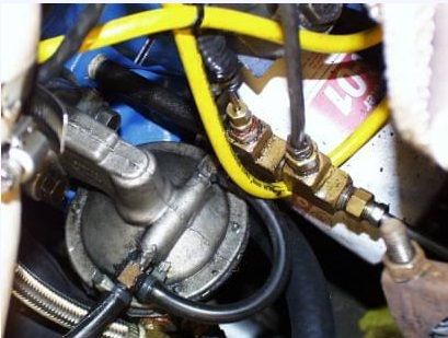

They had notes on the 120 gph Carter M4891 Super Strip pump for 350 Chevs.
It's a little X'y regards dollar purchase but its a well in excess of 9 pound pressure head pump that will need a Carter fuel regulator that regulates the pressure, not the flow, but it sure works.
Like this https://fordsix.com/ci/FuelPump.html
It can be boost referenced for a turbo to about 9 psi if the drilled section is opened out.
If you have to go electric or big flow mechanical, then you have to fuel regulate.
For regulating it, follow the big flow low pressure rule Does10's taught us.
On a carb instillation, you need a return line to lower the pressure, not regulate the flow. If you have an EFI style Mallory 250 fuel pump, you'd run a fuel return as big as your fuel supply line to your carb. If its less than the gallons per hour specs on a Mallory 250, you'd then look at the a line smaller, the same as the vapour line from the tank. It would have to be steel or rated rubber, and deposit fuel below the fuel filler, preferably the way it does on a factory instillation.
In a full accelleration launch, return line fuel has to go into the tank, and in an accident, there should be a inertial cut out, and an oil pressure cut out to any electric pump.

I believe the 28 or 29 GPH is factory. I'm running a Carter 35 GPH mechanical pump, through an aeromotive returnless FPR set at 6.5 psi. Have more than enough fuel for my 250ish HP 300. My pump is the one with the canister facing upwards.
From the summit racing specs, my pump is for all the falcon 6 and BB6 blocks as well as 390 FE(?) Might be worth some further investigation.
