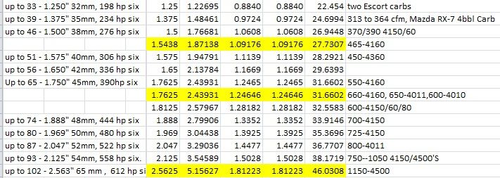

Red rose racer wrote:Have the 4bbs manifolds come so far , why are they used more than the multiple carb manifolds, like 2x2 or 2x4 or 3 singles ,even 6 in a row , one per cylinder. With the computer controled engines of today why not more.
Weber master Pat Braden in his 176 page HP Book Weber Carburetors says
1) engines with multiple divorced throttle bodies and carbs need a very bulky intermediate shaft to unload the throttle from any non linear forces.
2) Port on Port, Isolated Runner and Independent throttle systems (like Cobra Daytona's, 289 GT40'S, Halls US Pantera GT5's et all)
, each require
a) very high quality intakes and throttle balance that is not upset by internal signals,
b) that can be independently balanced using either a common vacuum balance line, or by individual vacuum sychro-testing that
c) doesn't influence the curb or wide open throttle angle during synchronization.
Everything has to be perfect, and that costs big bickies.
3) The use of power valves is generally a crutch to supply fuel under a low vacuum situation. 4 and 2-bbl Holley carbs reworked for In Port on Port, Isolated Runner and Independent throttle systems, often require power valve elimination and an intermediate circuit like a Weber , Edlebrock or TMP Power Plate. In most cases, its considered easier to ignore a, b and c, and move away from simultaneous operation, and go back to the Offenhauser Ford 144-250, 340/440 Six Pack or J2 Oldsmobile or 389-421 GTO Tri-power center on, outer secondary system. Power valves, vac secondary or mech outer operation avoids the need to add an intermediate shaft, and allows the center carb to operate kickdown linkages and most of the idle can still be six cornered with the outer carbs still supplying fuel at idle to keep fuel fresh.
4) With Port on Port (POP), Isolated Runner (IR) and Independent throttle (ITB)systems the flow speed is simply massively dropped from 265 feet per second on some 4-bbls to less than 18 feet per second in some 6-bbl cases. They are designed to stall air speed so each venturi and pulse tune like an alternating current, sometimes creating a romantic fuel standoff situation which also requires expensive flame arresting air cleaners and elaborate methods to contain the haze of gasoline so the aromatic hydrocarbons don't go on fire.
5) Carb sizing goes haywire based on the idealized 400- 1000 cc cylinders our over 3 liter sixes and 500 cube Cadillacs have. When Isolated Runner, If the carb venturi's don't supply air for the sweet spot rpm where maximum power occurs, the power band goes into a unstable zone where extra revs fail to give extra power. It can even nose dive where the engine has a cyclic power wave which an engine or chassis dyno operator will mistake for spring surge. Going up in venturi size is massively expensive because six throttle bodies then need to be upsized.
For an engine with 819 cc per cylinder, you have to extrapolate the target ventri diameter in mm and source a relevant carb.
See viewtopic.php?t=77685
Even below 500 hp, Cotton Perry and the late Jim Hedrick found out that IDA 48 Weber 2-bbls had restrictions in terms of total venturi area.
After 1978, In terms of net venturi area to support an independent runner intake, they found it was its pretty hard to beat this for a 292-300-310 cubic inch in line six
Above you are three 780 or 800 cfm carbs. (Not installed from the factory, but available as an "over the counter" service item only, the 1968 -1969 Holley 4bbl Camaro 302 Dual Quads List #'Numbers replacement #4210 or new ex dealer # 4053 or #4295)
For the Chevy II with its 292, they were used to get the rev range into the usefull 7000 to sometimes 10000 rpm bracket. Three Holley 4-bbl 4150 PN 3923289 DZ Holley # 4053 PN 3957859 Holley # 4295 carbs were based on the old 396 350-375 or 427-430 hp and similar to the later 290 hp Boss 302/390 FE pr GTHO 351 Phase III carbs.Those all have a ventrui area of about 3.108 sq in per two barrels. That's the same as One 2" venturi, and supports about 650 hp at 8400 rpm for approximately 820 cc per cylinder on a 300 cube six.
See https://www.12bolt.com/cotton-perry.html
On barrel of a ID 48 has a nominal venturi of about 42-44 mm, so a 43 mm venturi is 2.25 sq inches. A 600 4-bbl Holley, or a 660 center squirter 4-bbl has 2.58 sq inches per 2-bbl, or 5.16 sq inches total from Table J, total Venturi area.
That's about right for a 300 six reving to 5500 rpm.
The idealized Weber IR curves are still the optimum,, but as stated before, you can grab three 4-bbl carbs, and phase each 2-bbl to equal the total venturi area of a bigger Weber DCO or IDA/IDF carb without the expense.
Best bet are 1:1 linkages for secondary operation, and conversion to Four coner idle, but 4-bbls pulse tune just like a Weber if the net venturi area is matched to the peak power rpm level.
"Pulse tuning" for carbs only happens at about 11 to 18 feet per second of air flow, so you have to go big. Forget all that CFM flow rate hocus pocus. Only focus on the ventrui area required to match the peak power rpm. Then engine will rev above the peak power rpm. 5500 rpm is a good figure to punt for.
Your limit is the space under the hood, and the proximity to the spring tower braces or spring towers if its an XK 200 based X shell Ford your slaping the 300 into.
Basic MINIMUM SIZE ITB references for GROSS engine dyno BHP per cylinder,
assuming a 5 inch from butterfly to valve head and a max of 9,000 rpm are;
Up to 30 BHP - 30mm, 180 hp six
up to 33 - 32mm, 198 hp six
up to 39 - 35mm, 234 hp six
up to 46 - 38mm, 276 hp six
up to 51 - 40mm, 306 hp six
up to 56 - 42mm, 336 hp six
Up to 65 - 45mm, 390hp six
up to 74 - 48mm, 444 hp six
up to 80 - 50mm, 480 hp six
up to 87 - 52mm, 522 hp six
up to 93 - 54mm, 558 hp six.
Divide by 25.4 to get proper units, and then multiply by 1.2 to get the indicative carb throttle size.
I've underlines FTF'S 58 MM intake throttle to the head suggestion. Well, It works out to a 1-7/8 venturi and a 2.28" throttle. You'll not find that easily.

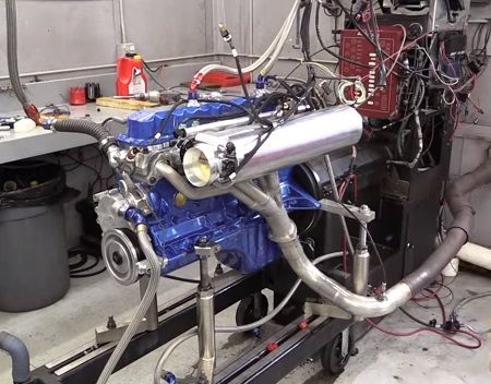

When Ford made 240 to 260 hp BDG Cosworth Four cylinder race engines for the World Rally Championship, it found Lucas Mechanical injection was cheaper than Webers expensive DCO's or Downdraft IDAs or IDFs.
A great example from Preparation H's 300 Ford making about 400 hp net from three Weber ID 48s with six 42 mm venturi carbs.

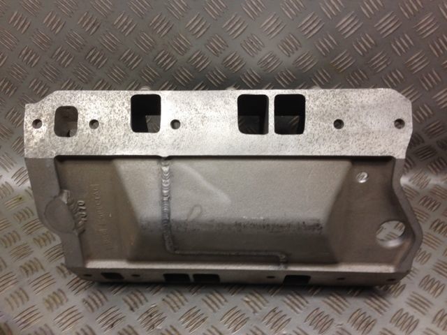

Here is my take an outworking of Grumpy's ITB/ Port on Port, Independent runner Cut down V8 Tunnel Ram ---> GM V6 racing engine idea from that 1982 book.
Picture source
viewtopic.php?t=48448
super4ord wrote:Here's a decent shot of the Clifford's I've found. The triple Holley style with the adapters and the triple downraft Weber style are NOS. The mag is a Ronco. Haven't decided on which intake to use yet. I kept one forged crank too. Sold the other to Gord. I'm still looking for an SVO block and waiting on Mike's 300 head. Image[/img]
Now some details. When each port to an intake valve is ITB/ Port on Port, Independent runner, the Carb venturi's then only need a bare minimum of carb venturi to trigger a certain horsepower. Note...carb venturi size, not throttle size.
So it works by this matrix of numbers. I don't like mm's,
hp gross at per cylinder and total
Up to 30 BHP - 1.181" 30mm, 180 hp six
up to 33 - 1.250" 32mm, 198 hp six
up to 39 - 1.375" 35mm, 234 hp six
up to 46 - 1.500" 38mm, 276 hp six
up to 51 - 1.575" 40mm, 306 hp six
up to 56 - 1.650" 42mm, 336 hp six
Up to 65 - 1.750" 45mm, 390hp six
up to 74 - 1.888" 48mm, 444 hp six
up to 80 - 1.969" 50mm, 480 hp six
up to 87 - 2.047" 52mm, 522 hp six
up to 93 - 2.125" 54mm, 558 hp six.
650 4 BBL 4150 Series Holley Carbs have
Venturi inlet: 1-1/4"
Throttle bore: 1-11/16"
that's 31.75 mm, enough for 198 hp. On a 300, a BT, Before Turbo, before an blow through turbo hat on conversion, the power band would be at 3600 rpm. You would have to 22 pound boost, and that might give a 2.52 boost ratio, and maybee, 500 hp gross.
For a Twin Converted 3 bbl, the 255 to 310 hp range is here. To get 500 hp boosted, you come down on effective boost ratio. 14 pound for the BG Demon RS 1.425, 9 pounds for the Holley Ultra 1.600.
4150 carbs with 1.75" throttle plates.
1. BG Demon RS 1.425 venturi
2. BG Gold Claw 1.500 venturi
3. QFT/Proform 1.450 venturi
4. QFT/Proform 1.520 venturi
5. QFT/Proform 1.590 venturi
6. Holley Ultra 1.580 venturi
7. Holley Ultra 1.600 venturi
AED, CSU, any number of brilliant ITB tuners can sell you custom adjusted venturi's.
The 4150 4bbl based Braswell B-4825 Series carburetor is offered with venturi sizes from 1.40" up through 1.68", and throttle bores of 1.688", 1.750", or 1.790
The biggest carbs are 4500 based Dominators and CSU's.
Braswell and many others make different venturis. 1.90"-2.22" venturis and 2.20"-2.60" throttle bores on the B-7520 2-bbls and B-7395 4-bbls.
I like Dual 660 center squirters,
triple 500 Holleys with the venturis taken out from 1.375 to 1.4375 by fettling, and those give you an Isolated runner 255 - 265 HP with relative ease, at about 4600 rpm. Then add 14 pound boost, and you've got an assurance of 500 hp.
Any time you increase the venturi's to serving more than one cylinder, the pulse tuning effect dies, and your better off forgetting all this ITB/IR/POP hocus pocus.
That's the 6bbl math.
So the summary is for six barrels, 198 to 310 hp from 1.25 to 1.600 venturi carbs. To get 500, as much as 22 pound of boost or as little as 9 pounds.
Now, if you use three 4-bbl carbs, the average Venturi areas must match the table I used above. it becomes 12 bbl math.
So donner Dual 2bbls and 4bbl Hitachi/Nikki Holley's are here :-
You would need "six" 2bbl Escort carbs to make an independent runner 300 produce just 198 hp at 3800 rpm.
You would need three RX-7 carbs to make an 300 produce 234 hp at 4200 rpm
You would need three 390 cfm 4bbls to make 276 hp at 4700 rpm
You would need three 450 to 465 cfm 4bbls to make 306 hp at 5100 rpm
You would need three Custom venturi 480 -500 cfm 4bbls to make 336 hp at 5400 rpm
You would need three 550 cfm 4bbls to make 390 hp at 6000 rpm, or a triad of 660-4160, 650-4011,600-4010, or 600-4150/4160/4180
You would need three 700 cfm 4bbls to make 444 hp at 6500 rpm
You would need three 725 cfm 4bbls to make 480 hp at 6700 rpm; Q-jets or ThemroQuads would work
You would need three 800 cfm 4bbls to make 522 hp at 7100 rpm
You would need three 830-1050 cfm 4bbls to make 558 hp at 7500 rpm
You would need three 1150 cfm 4bbls to make 612 hp at 7800 rpm
This backs up post viewtopic.php?f=2&t=77272&p=594767&hilit=Mazda+4bbl#p594767

In this video are two intake manifolds.
The second one with the round plenum attached to individual runners and a throttle body at the end (nicknamed the "Cannon") is the style that would work for both naturally aspirated and turbocharged drag racing application.
This is what I was trying to refer to at the beginning of this thread.
https://www.youtube.com/watch?v=YWcZMjA7ZgQ
You can consider it as an independent runner intake with all benefits described in the above posts only with a single throttle body entry point.
Posts: 7174
Re: Single 4bbl verses multi carbs
Post #82 by xctasy » Wed Oct 07, 2020 11:11 pm
pmuller9 wrote:In this video are two intake manifolds.

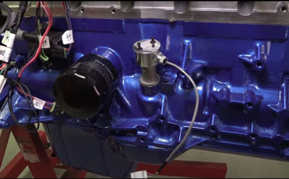

Up front Single Throttle body, Cannon Air Atrium
Hogan style manifold with down draft throttle body
Sequential Injection Cam Synchronizer with Bernstein sensor
(for Port EFi sequencing which is no longer every second injector gang fired)
Red rose racer
