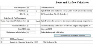

http://www.rbracing-rsr.com/calcboost.html
I took a screenshot, slapped it into mspaint, saved as a JPG, resized it to fit the forum rules and viola!
It says we need 13lbs of boost on a 200 to make 300hp, and that will require 408CFM of air movement.
