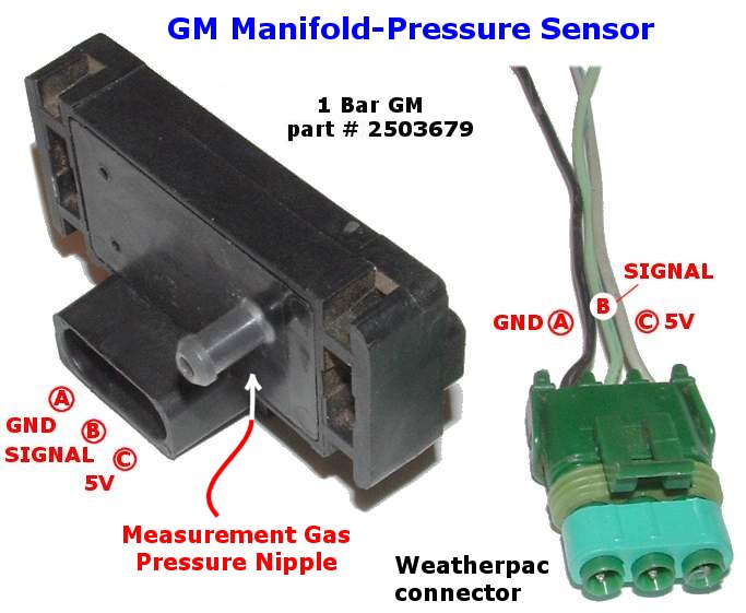

MAP sensor (do you guys have any specific brands?)

What are you using as an engine computer? Megasquirt, etc, etc.? That will help decide what "brand" sensors to use. Typically when going completely custom like this I'd pull all of these sensors off a specific year and model GM car, that way if it ever stops working you can just go to the parts store and order it easily.

Map Sensor
