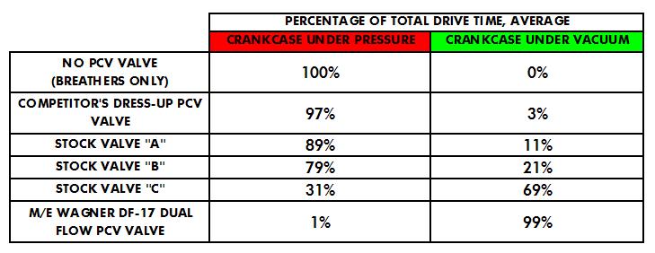

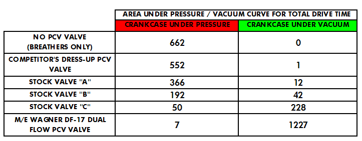

Postive Crank case ventilation totally influneces idle on carb vehicles,
Fords Holley Weber carbs had to be protected by specially calibrated EGR sensitive PCV valves, the demand cycle traded off against the blowby figures. On big sixes of 300 cubic inches, one valve services a 5 cfm peak blowby from all six cylinders. If its has no EGR and a 1-bbl, its one type of really simple valve. If its EGR, they have a balanced type.

The right PCV can allow a much more sensitive air blead calibrated carb to operate. Often, just baffels below the PCV are enough, but the Wagner Adjustable PCV avoids high blow by charge dillution, which is another huge issue on why the air bleeds clogg up. Basically Ford of Europe sorted the idling issue out with bleed back fuel lines, and balanced PCV with an air baffle to stop oil consumption from blow by.
